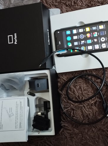

The package is clean and neat and heightens the expectation while opening it.

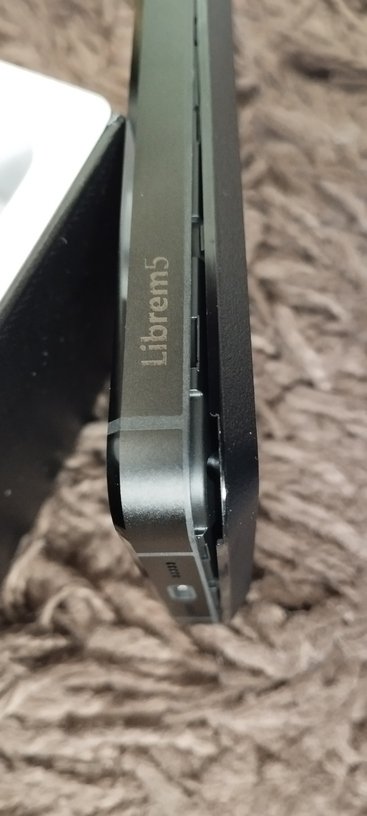

The device is heavy, you can hurt someone if you throw the phone at them. Metal all around, which is needed because the device runs lukewarm. (Just 6 hours of operating time). Louis Rossmann would approve of the space for your nail in the corner, which helps open it up (there's no need to open it, but it has the bottom half for a fat battery and the top has all the electronics, which means the battery is not the primary heatsink, as with conventional phones). The clicks it makes when closing are satisfying ASMR.

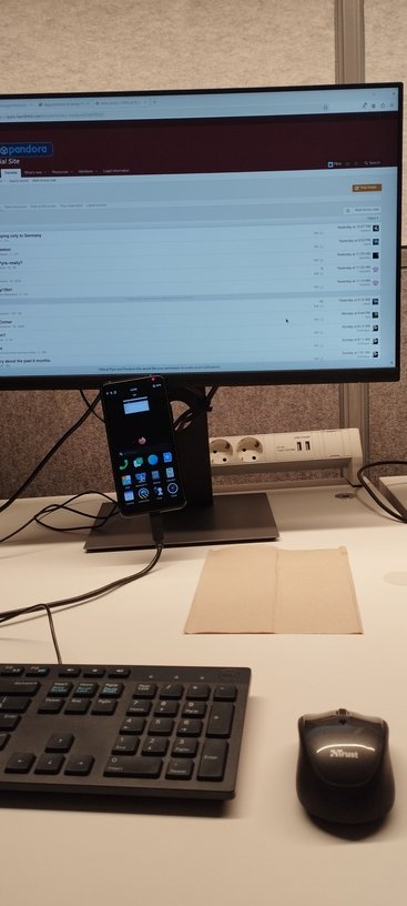

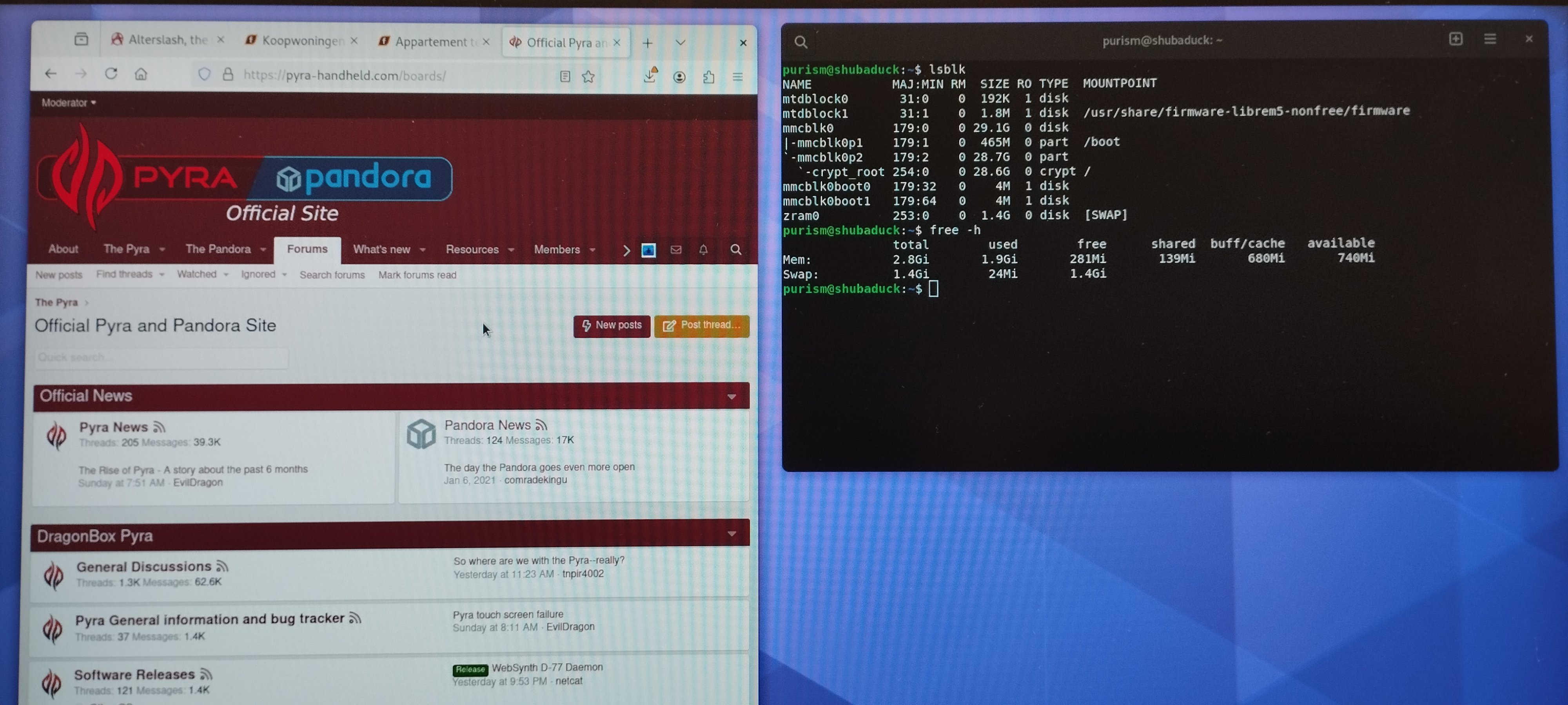

Desktop Mode

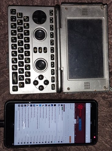

Just like the Google Pixel, you can connect the phone to a monitor/mouse/keyboard and enjoy highres. It felt even more useful, as you have all applications you can install using the Debian-ARM repository (similar to Pyra/Pandora). But YMMV, as you don't have native Google software. CPU is ok to work with. But there is no graphics acceleration. So slither.io on the browser crawled to unplayability. But normal webpages scrolled well. Having access to a real Firefox browser (instead of a skin) is quite the luxury. Mouse movement never got stuck, and moving applications from the first screen (phone) to the bigger screen (desktop) is possible after you learn how.

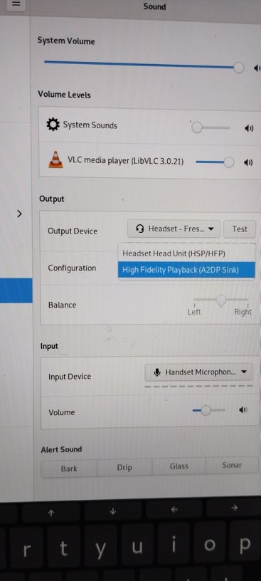

Audio
Audacity shows too much hiss when recording from the build-in mic. However, playback is top-notch. Connecting Bluetooth headphones with microphone is easy and eliminates the hiss (because it's converted to digital before it's being send to the phone). Bluetooth headphone autonomy (how far you can walk from the phone) is identical to my Android phone. Because the CPU is always in high-power mode, there is no interruptions in the audio, like you get when the Android phone is in low power and it decides to to a background task.
