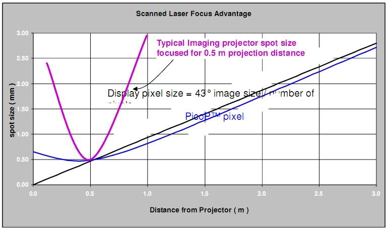

The funny thing about speckles is that they are roughly the same size regardless of spot size and distance to viewer. They behave really contraintuitive. I can even see them sharply without glasses (when everything else is a blurry blob to me).
As for the scanning, that's another neat thing that's only possible with lasers: They made it so that the beam diameter is proportional to the distance, meaning the spot or "pixel" always takes the same fraction of the whole picture (that's also why the image is always in focus).
This makes me think the scanning effect should always be the same, regardless of distance/image size.
