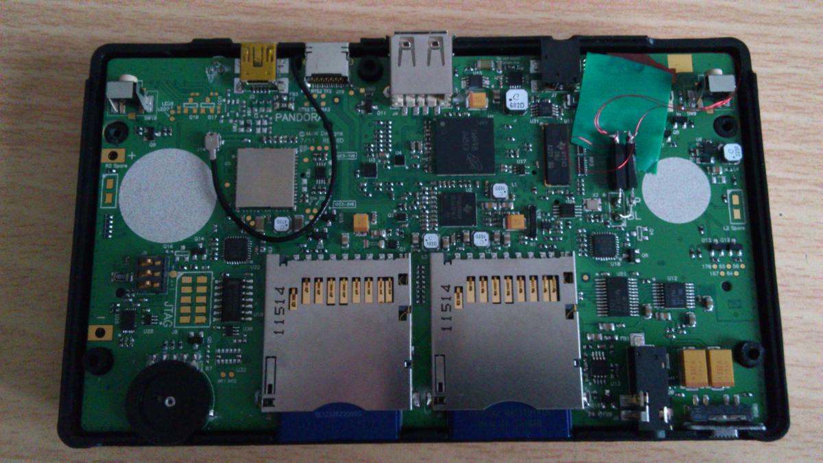

Hello,
some days ago I have added some keyboard lights to my Pandora. Therefor I followed this tutorial.
It worked great untill this morning. Then I first had a loose connection between a resistor and the LED on the right. Later both LEDs stopped working.
Now, I have fixed the connection and both should shine. I even have connected a power supply to the Illumination and everything seems to be OK with it.
But it doesn't get powered though.
It looks to me like there is somewhere a defective fuse on the mainboard.

I have measured the connection between the mainboard KP_Light connector and the plug from the LEDs.
Also I have connected a seperate PSU to the LED plug and they work properly.
EDIT:
Ouch, that's embrassing!
On the last attempt, I accidently confused + and - on my LED plug. Now I turned it around and it's working.
Problem solved.
Okay, does sound like something on the pandora board has gone pop.  Looking at my spare board, I can't see anything that looks like a fuse to my eyes near to the KP-BL pads on either side of the board.  I would hope those pads are fused rather than it taking out the CPU GPIOs, but I don't know.
To be honest I don't know of anyone who reads here regularly that would know the board well enough to advise you on that level of detail.  But hopefully I'm wrong.
It's fixed now, but here we have the connector (on the right):
