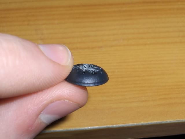

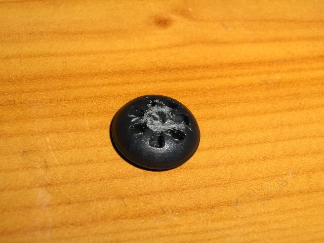

Here's a couple of pics of what I've done to mine. Hasn't improved the directions for me, but then the problem I have was right and up-right being too close rather than problems registering left. The pad feels much nicer now though.
Thanks for the pics, Im going to wait until I get my dremel next week so I can make a decent job of it. Also going to be modding some other joystick heads Ive found. :)
