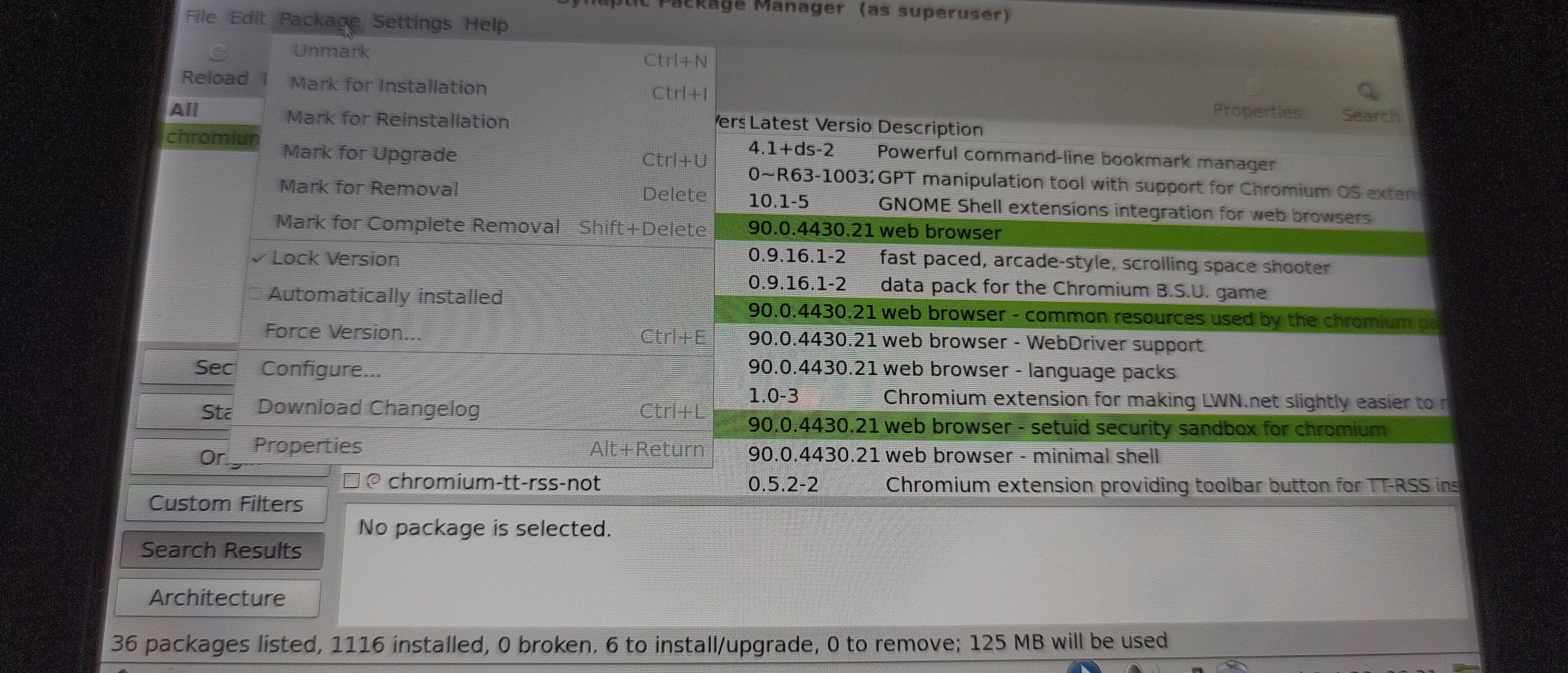

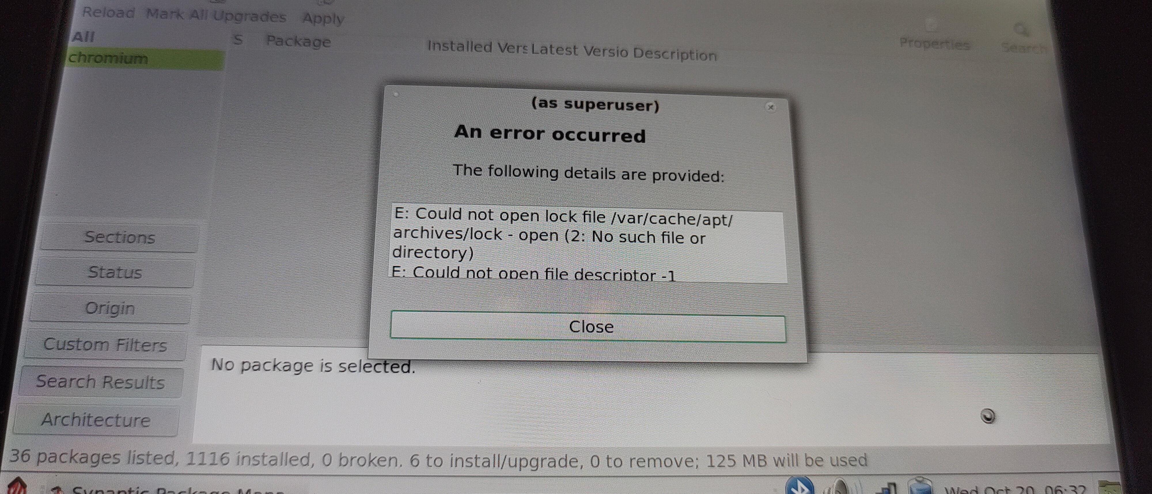

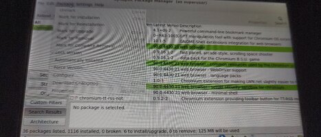

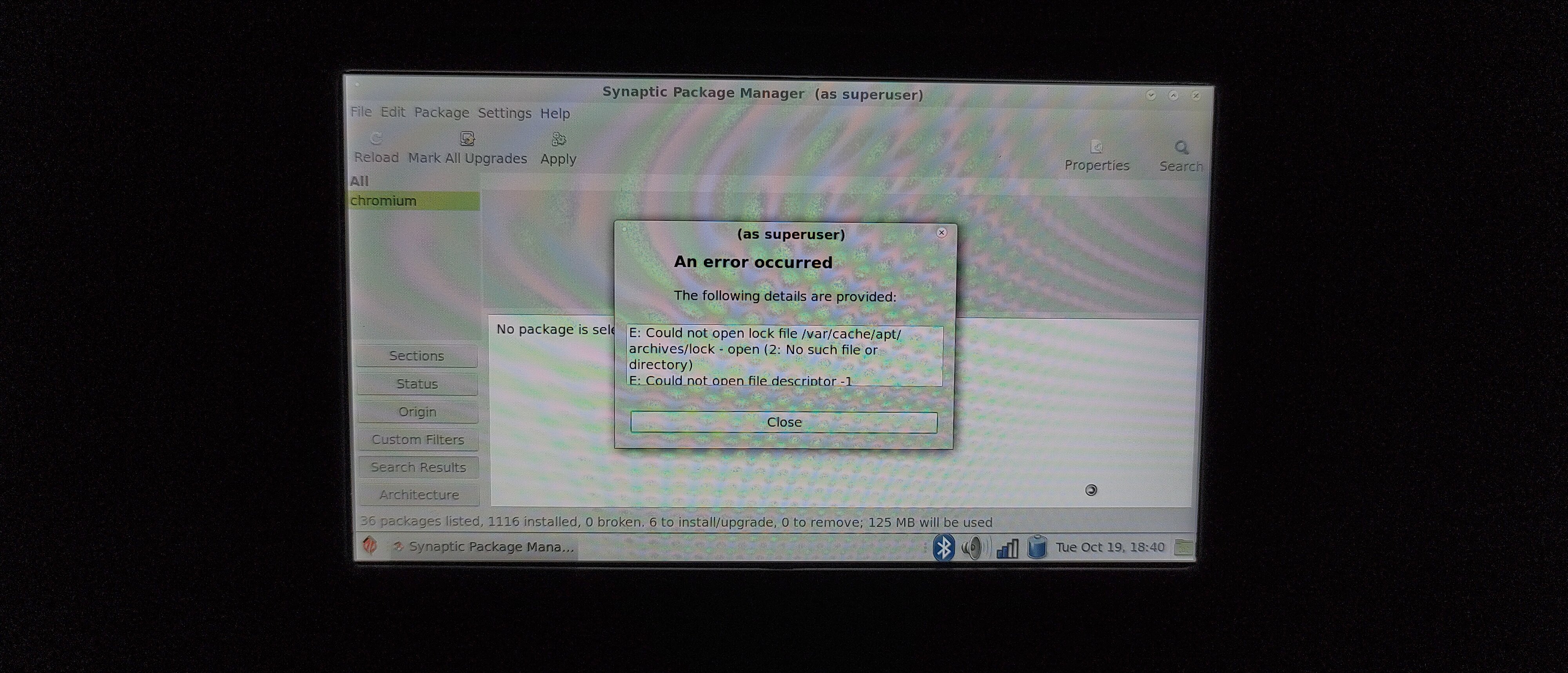

I try to install chromium i mark it and i apply dependencies. Here is the error why?
Hmm, that's weird. I'd suggest you check if what it claims about that file is true or not. I might personally expect the lock file not to exist when the repo is unlocked, and only appear when it is locked. Maybe the problem is it's unable to create the lock, and then it actually fails in trying to read it back.

How to lock and unlock the repo?
Edit:
Package - Lock
I try like on picture i try to install clicking on apply without luck same problem. How to resolve problem?

Try going to the console and become root, then:
Code:
D=/var/cache/apt/archives ; mkdir -p $D ; chmod 777 $D
maybe the directory to create a lock file does not exist? (or maybe it DOES exist but there is too few rights to create a lock file there? (That's what the chmod does)
It work now. Thank you. Chromium installed.

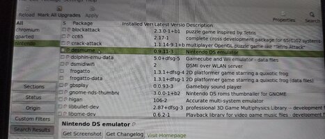

Anybody try desmume or dolphin emu on Pyra?
You think it will work at full speed?

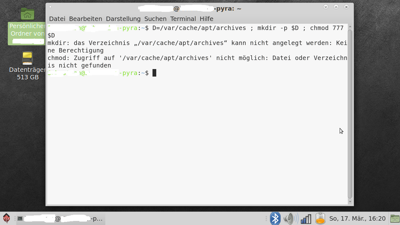

If I try to enter "D=/var/cache/apt/archives ; mkdir -p $D ; chmod 777 $D"
It is not working because of USR rights (see attached picture).... How do I become root?
Sorry for the questions I am not used to linux.

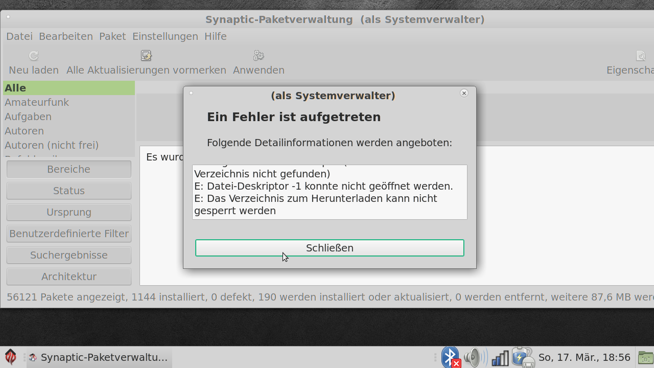

Also genau wie trevormacro kann ich im Paketmanager keine Programme installieren und bekomme so ne Aussagen wie (siehe Bilder - bei ihm war es auch so siehe das zweite Bild im Posting #6). Daher habe ich die Befehle in der Konsole ausprobiert. Aber bei meiner Pyra tut sich nix. Ich kann kein Update machen und keinen Browser installieren etc..
