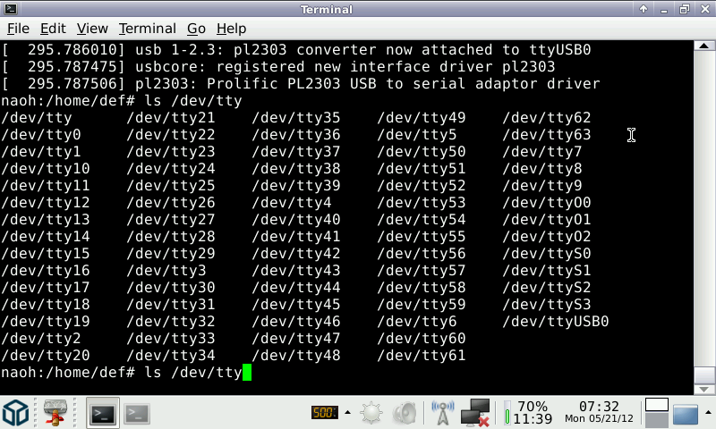

It works through a compatible powered USB hub.
http://pandorawiki.org/USB_compatibility_list#Compact_USB_Hubs
The usbserial module has to be loaded.
Plug the devices, then activate USB.
100 mA.
But i have to power the hub.
I don't know why.
It's usb 1.1 by the way.
