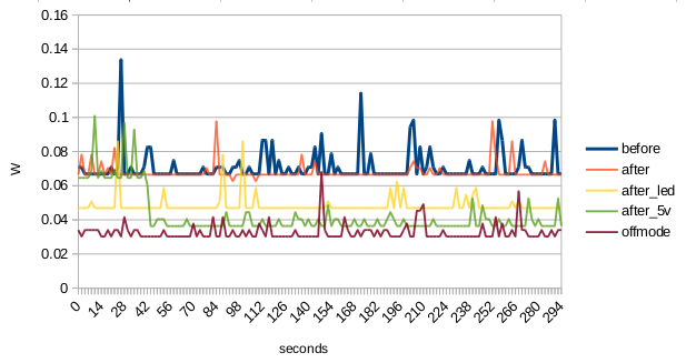

Idle optimization
So I've managed to squeeze yet more by making use of the so called OFF mode of the SoC:
Run the update and enjoy (or suffer some new bugs, everything seems to be fine for me though).
I thought OFF mode was completely non-functional in 3.2 but it turns out to work at least on some parts of the SoC (power domains). Turning it on globally messes up GPIO state and things break badly though.
It's a shame it's impossible to turn off the nubs, attempting to do so results in some sort of leakage and high power usage. When this was noticed the rebirth/1GHz production was already started and trying to fix it would have resulted in delays and lost money for ED. Perhaps somebody could desolder the nub microcontrollers someday to see how much they actually eat.
