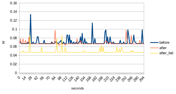

    As my pandora spends most of it's time idle waiting for me to do some occasional hacking (something becoming more and more rare), I've decided to do a few hacks on background processes to reduce their activity. The other rather obvious thing to reduce idle power usage was to dim the power LED (which turned out quite significant, no idea why it wasn't done before, you can edit /etc/pandora/conf/led.conf to customize).
    [​IMG]
    If LED is ignored. the improvement is a bit hard to detect with the fuel gauge (battery monitoring) chip, as reading the chip itself requires waking up the CPU (obviously) and OMAP peripheral power domain to activate i2c. Still I think it's quite visible.
    Run "Upgrade Pandora OS" to get this stuff. As usual chances are that something got broken so testing is welcome.

    CapcomSuicide, lukey, ElPoco and 11 others like this.

    Do you have any benchmark running to see how much difference it makes in battery life before/after the changes ? any rough estimation ?

    Benchmarking this stuff takes a lot of time, mostly because the battery drains so slow in Idle.
    This appears to be saving about 30%, which would mean 30% longer idle time (which is great).
    ingoreis likes this.

    Like TeDaDeS said it's quite hard to measure, and I'm not curious enough to reflash back to old firmware to measure it.

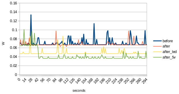

    I've managed to squeeze some more by finding a way how to disable the 5V supply:
    [​IMG]
    The 5V supply feeds the EHCI (aka big) USB port, audio amp and (on CC units only) the LCD. So now when all those are not used the 5V voltage converter is also turned off. This means that there is no longer power on USB port while USB is off.
    While at it, I've also disabled the expansion port power supply and added some new controls:
    • /proc/pandora/always_enable_5v - set to 1 to get the old behavior with always powered big USB port (if you want to use idle pandora as a portable battery pack, to charge a phone or something)
    • /proc/pandora/exp_power_mv - set the expansion port voltage in millivolts: 0 (default), 1500, 1800, 2500, 2800 or 3000.
    So go "upgrade pandora OS" and test, I hope I got all the code right.
    Eight Bit, FBnil, Linux-SWAT and 4 others like this.
