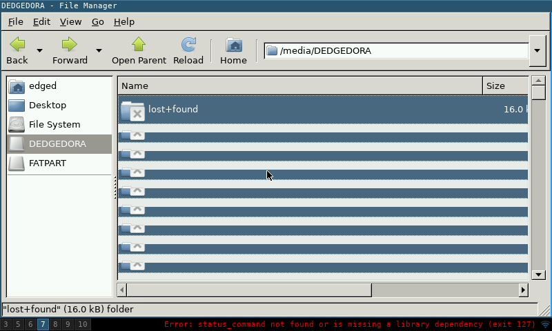

So I've noticed a weird bug. I suspect it might be coming from me moving the Cairo libs from ptitSeb's build of i3 onto my NAND, and that messing up GTK based apps. Apps such as Netsurf, Thunar, and Comix all have problems scrolling either up or left. Qupzilla is not affected.
It seems like when you scoll up, for example, the 2D libs are supposed to shift the visible window down, render the newly visible area, and insert that at the top of the window. However, instead of adding the newly visible area once, it repeatedly pastes the new portion all the way down the visible window. I'm posting an example from Thunar.
Any ideas, @ptitSeb ? I'm assuming I just need to revert to the version of Cairo from the opkg repo.
