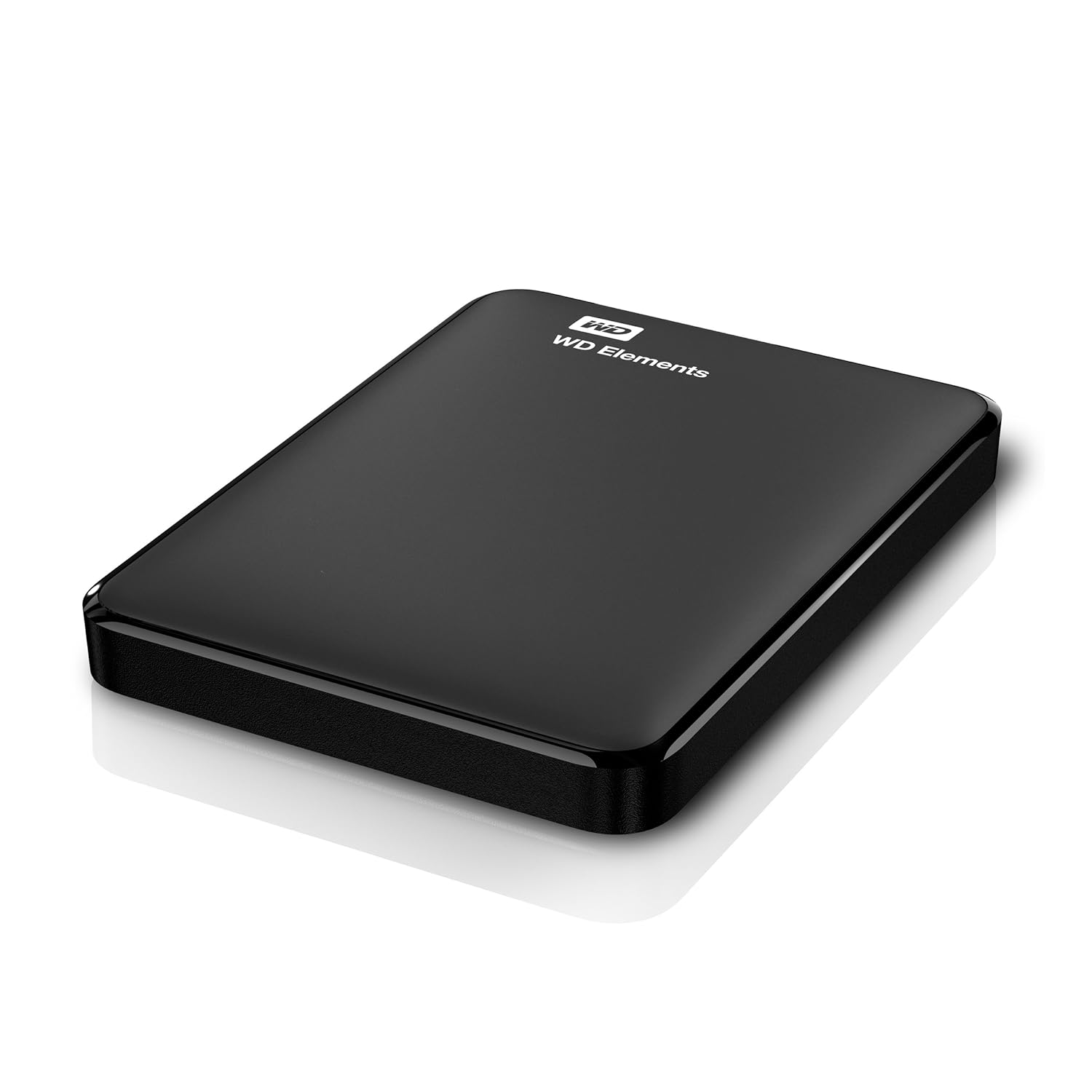

Actually, it does with my disk (WD Elements USB 3). And "touch /dev/sdx" gently wakes it up =)
Seeing that it wont work with any of my drives i assume the drive is not important at all, it seems the USB-HD case has to provide it.
Do you know what vendor the case is from? I might need that feature too.
Yeah, the USB SATA controller must implement SAT for hdparm to work. I have an original WD enclosure which doesn't really open, so I cannot check what's inside
