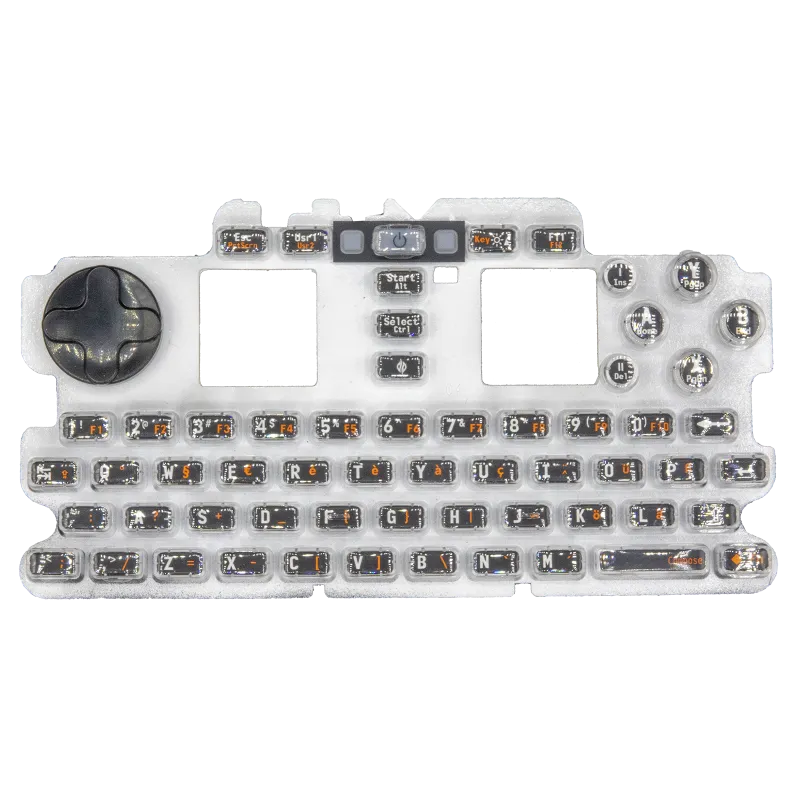

Additionally I miss two symbols we use, ñ and · Which I think can be mapped to USR1 and USR2, but I do not know exactly how to do this.
Not sure where USR1 and USR2 would be. Is this page up to date ?

I just read man xmodmap and man XCompose, but I assume you too. I hesitate to give advice in something I'm not sure and I can't try, but maybe use the codes
in the picture I linked above and see if that works better ?
