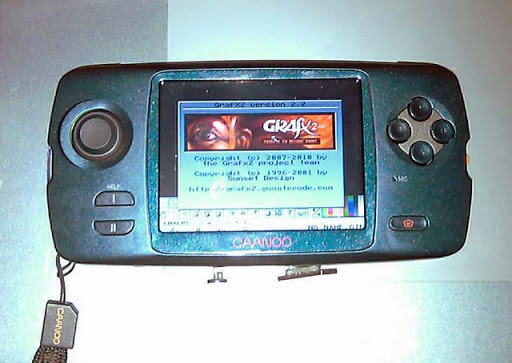

I also had an eye for this application. It compiles by GPH toolchain for the host configuration and running perfectly. I tried to make it to compile for target configuration. It's only success if i remove "-static" option both from compiler and linker options. Otherwise it can't found "-lts" which is "touch screen" library. It has nor ".a" nor ".la" files in arm compiler usr/lib dir. Without it i can produce ".gpe" executable but it hanging up on loading screen and the most sadly thing - i can't see any terminal output on target device, so i don't understand whats going wrong.

Well, good news everyone. At least i was able to run application on my Caanoo. The next step is to try to remap it on Caanoo keys.

Does the touchscreen work to paint ok?
Yes, touchscreen is work and i can paint with it as well. But there's something need to be fixed. A few of paint instruments create strange offset of the cursor when they are used. I need to dig into the sources to understand this bug. Also i'd like to wait until GPH release a new firmware, because there's will be touchscreen related fixes.

There is no virtual keyboard? because I can't seem to save anything because I can't type a file name.
As far as i know GP2X port also hasn't a virtual keyboard(i didn't find it in sources), but i think it isn't a big issue since the application is not a file manager. You can plug in a real keyboard through USB-port for filenames and other stuff as well. By default editor set a "NO_NAME.GIF" filename.
p.s. I did a big mistake by not including sample 8-bit paletted pictures into the pack. Now people are wondering why it hang up while loading a title and icon pictures... That's because they are 24-bit.

Hi, I'm working on the main code base to add virtual keyboard (http://code.google.com/p/grafx2/issues/detail?id=389)
I can only test on Windows with a mouse, so any feedback about the console port is very precious.
