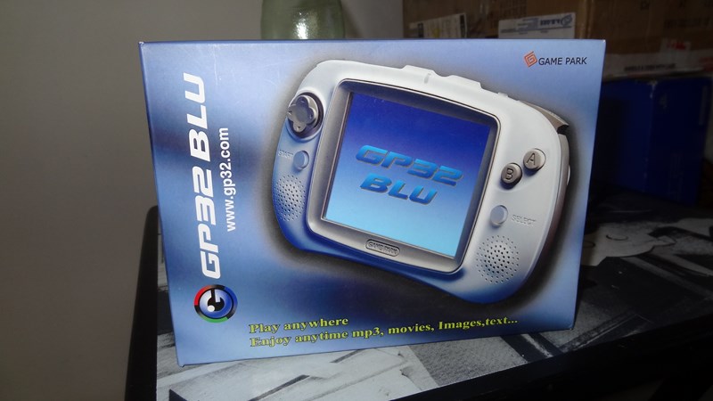

Hey, long time no speak, it's been 10 years since I first joined this site. :eek:
I got my GP32 BLU down from the loft yesterday and thought I'd have a go.
The unit turns on (red light) but the screen appears blank. Nothing happens.
It was stored very well, and has suffered no damage.
Anyone know what it could be?
Thanks.
Here it is:
