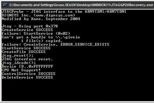

I ran gp2xrecovery last night, many many times without effect. I think there are a few potential problems here, including but not limited to: (i) I had to solder up my own parallel cable, which I'm certain is all good, and (ii) I don't have a power adaptor for the cradle, nor is the cradle getting powered from the 2X (there is no red LED).
Here's the screen I'm getting:
Any ideas? :) If it gets too drastic I'll see if the friendly guy at gp2x.net.au is up for looking at it (at least he'll be properly equipped with power supplies and confirmed good cables).
