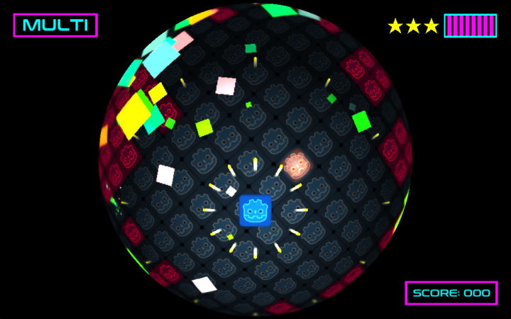

Added package of demo shooter on a sphere with Godot 3.4.1rc2.
Package: Spheroblast
Source: github repository
It is using a complex shader:

I think that's what makes the game so slow. Maybe it can be simplified.
