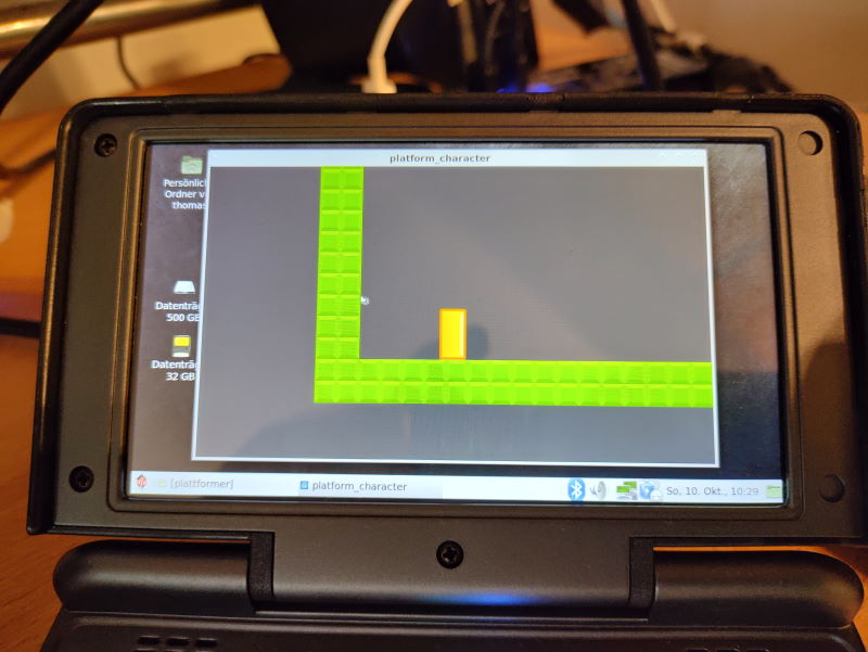

Just wondering if anyone has had any luck running Godot on a Pyra at this stage?
I've been playing about with it and have one practice game complete and another ongoing and it would be nice to eventually see it running on a Pyra! :)
The editor runs, but is slow.
Compiling is relatively easy. After installing some libraries from the repository, see Godot page, only the file "/usr/bin/scons" at the beginning has to be changed from "/usr/bin/python2" to "/usr/bin/python3" and then it compiles.
  • runtime: scons platform=x11 target=release tools=no CCFLAGS="-mcpu=cortex-a7 -mfpu=neon-vfpv4 -mfloat-abi=hard -mlittle-endian -munaligned-access" -j 2
  • editor: scons platform=x11 target=release tools=yes CCFLAGS="-mcpu=cortex-a7 -mfpu=neon-vfpv4 -mfloat-abi=hard -mlittle-endian -munaligned-access" -j 2
The whole thing takes about 1-2 hours per call.
I have attached the runtime with a very simple example, (32MB!), extract the archive where you want, and start the file "run.sh" in the directory. It takes a while, then the game is displayed.
The Editor (58 MB!) is the second file.

Replace the "run.sh" inside with
Code:
#!/bin/sh
# Resources: https://github.com/ptitSeb/gl4es/blob/master/USAGE.md
set LC_ALL=”C”
export LIBGL_ES=2
export LIBGL_GL=21
export LIBGL_FB=0
export LD_LIBRARY_PATH="/usr/lib/arm-linux-gnueabihf/gl4es"
# texture too big, enable this
#LIBGL_SHRINK=10
./godot.x11.opt.32 ./
and your fps goes from 17 to 146, but unfortunately only every second or third time. Godot starts but stops after a few seconds.
