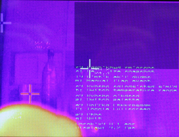

Hi,
so can you see the difference between both pictures?
Lunixbochs:
ptitSeb:
And i mean not the Text-Issue.

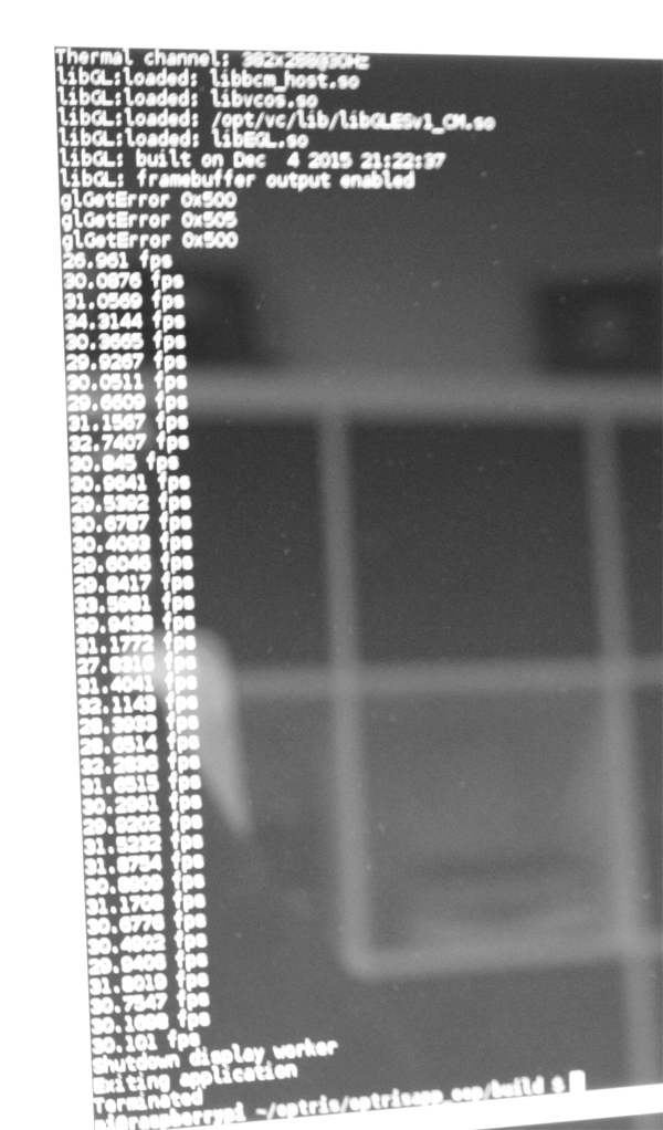

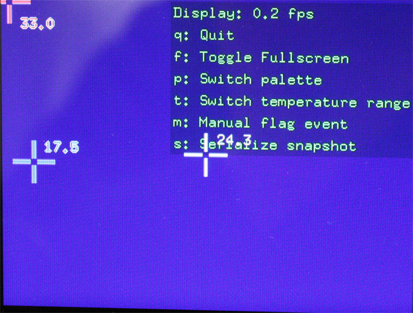

On the second one there is no rendered IR_Image... only an blue screen.. first i have tought is while the CAM is not moving.. but when i close the app.. i see only 10 of my FPS Calls  from 27-0,2fps showing on the console... by using ptitSeb and i see 50 of that fps calls on my terminal in quickly response show me 30-40 fps if i use lunixbochs.
So i think the software is stopped or extremly slow... but is thre slow because of to many calls? But thre is no rendering image from the CAM...
Ok, so the issue is probably comming from some format conversion bug regarding the video feed. Is this software opensource (so I can look at how that feed is handled)?
There's definitely some sort of performance problem; the code snippet @lunixbochs linked to (attached) is causing system loads around 1.0 with his own glshim whereas @ptitSeb's is eliciting around 2.0 (Mali driver on Odroid C1)
The immediate difference seems to be the huge amount of scrolling on the terminal that printing
libGL: warning, gles_glBlendFuncSeparate is NULL
  is probably causing (even when you completely cover that xterm window)

Here you can see lunixbochs branch i have testet for 2 minutes and then quit the app to see my fps output. You see from 30 to maximum 40fps. Is enough for me.
Interesting is some glGetError 0x500 at the beginning...
@ptitSeb
Bingo! I've just squashed the printf's in src/gl/loader.h which brought performance in line with @lunixbochs's version.
I have no idea if it's only affecting Mali but clearly it was very CPU intensive. (didn't impact rendering performance but worked a full core needlessly)
@ptitSeb
The printf in the WARN_NULL macro? It was triggering on the ODroid? On which function?
Did you miss my post above? (libGL: warning, gles_glBlendFuncSeparate is NULL)
