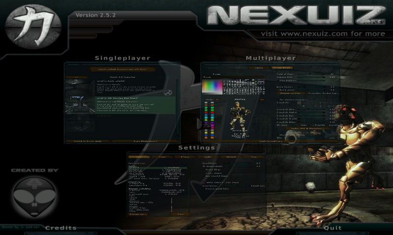

My nexuiz build is mostly vanilla.
But you probably need my fork to make it run without changes in the code.
That's what I'm using right now (git clone https://github.com/ptitSeb/glshim;cmake .; make).
Hmmmm, I pushed some changes, so maybe "git pull" and "make" again, so you'll have the same version as me.
For darkplaces, I use official SVN repo.
Here is my current diff:darkplaces.tar.gz

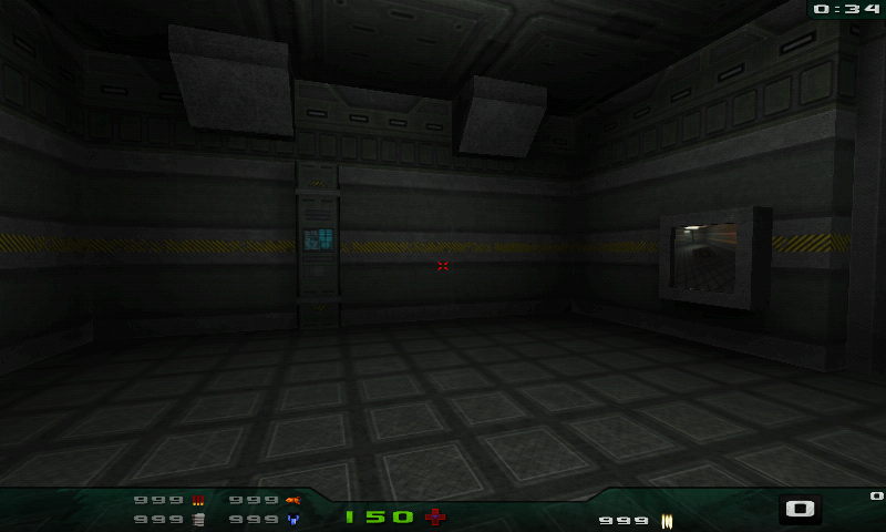

After a "make sdl-nexuiz" you have a runing nexuiz... The tuto in the 2.5 single player level run fine in low detail, but first combat after that is not smooth enough... But I have everything runing fine visualy..
