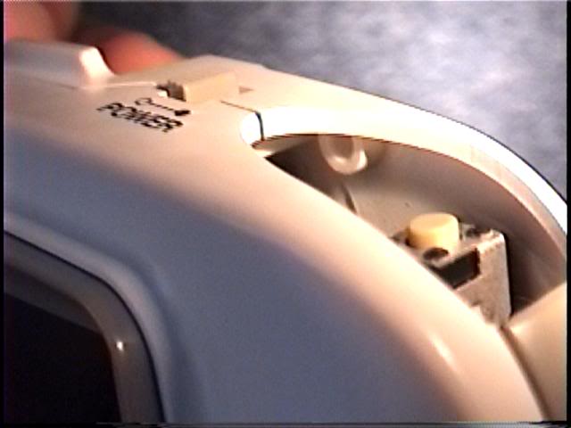

So, when I took out the shoulder button, I saw the actual R button:

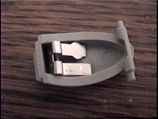

I tried clicking it a few times just to check it out and it worked fine. So, my first thought was to leave the R button out and just use it like that, but, I had a feeling that would be too ghetto, so I took a look at the actual R button:
(When I first tried to take the R button out, that metal piece got loose and fell inside the GP32, so, after jiggling it around a bit, I managed to get it back out and put it back on)

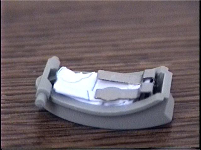

Is it supposed to look like that? If so, that's a horrible design. Anyways, just to make sure I could, I put the shoulder button back on, and I noticed that it fell down instantly (there was nothing supporting it), so, it was too loose. At this moment, I thought maybe some piece that's supposed to support it fell into the GP32, unforuntately, I wasn't able to obtain it. So, I decided to make my own support, several folded pieces of paper:
(I tucked in the paper on the left side of the button before I put it back on)
So, after putting it back on, I got excellent results.
So, what do you guys think? I'm guessing something similar to this has been done before because it's a relatively simple solution that someone was bound to think of after looking at the button.

Well, I needed a fix right away, so it's not like I could go to an arts & crafts store or something and pick up something a little more "appropriate." I just saw a stack of paper on my desk and decided to try it out.
Hahaha.
I guess my gp32 will look f*cked up a fter a few years.
Stuffed with pieces of toilet paper an held together with tape.
No matter if the emu's keep working...

I just used this fix on my BLU -- it came with BOTH top buttons dodgy. I slipped some cardboard in, folded a few times and cut to shape -- works perfectly.
Thanks Azure!
