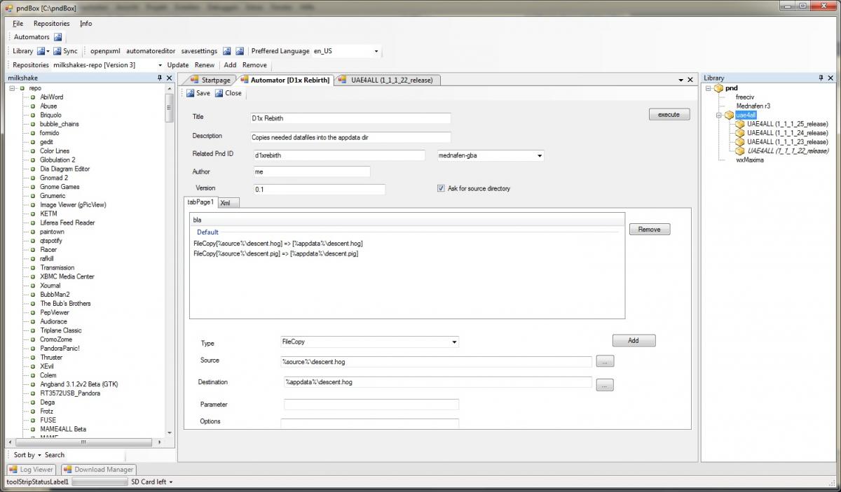

WIP Screenshot:

As the pndviewer still needs a lot of work, the screenshot shows the automator editor, so the save button just saves the automator to disk. I already adressed this - see "Managing"
