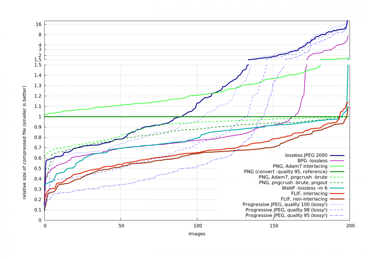

Here are the results of my compression benchmark:
As you can see, FLIF beats any other lossless image format in the test.
You can also clearly see how much JPEG and JPEG 2000 suck on non-photographic images. Just look at the right hand side (the images they don't handle well), and take into account that the top part of this plot has a logarithmic y-axis!
FLIF even beats lossy JPEG (at high quality). At low enough quality JPEG beats FLIF on half of the corpus, but on the other half, JPEG is so crappy that overall, FLIF wins easily. And that's even though JPEG has no alpha support, so for the images that have an alpha channel, it's not even encoding that!
I'm quite happy with these results. They are very promising.

What does your X axis refer to exactly?  'Images' - is that number of images.  If so, does that suggest that after 200 images, 200 flif images take up more space than 200 PNGs?
I wondered this, but if you read above, he's got 200 images - I assume each "one" on the X is a different picture. Pictures will vary in size and complexity, thus giving the differing levels of compression.
I think that's right
No, it's not cumulative, it's just sorted from best relative compression to worst relative compression. So if you look at the middle of the X-axis, you get the relative file size of a 'typical' file. At the far right you see the worst-case behavior, at the far left you see the best-case behavior.
In other words, in the worst case, FLIF outputs a file that is 15% larger than the corresponding PNG file. That only happens on a couple of files though. A typical FLIF file would be 35% smaller than the corresponding PNG file. In the best case you can trim away 80 or 90% or so.
But those extreme cases (best and worst) are probably not that interesting. It's probably the middle segment that is most representative.
Most certainly not: the total size is more like the area under the line (but that's assuming that all original files have the same size, which is not true).
