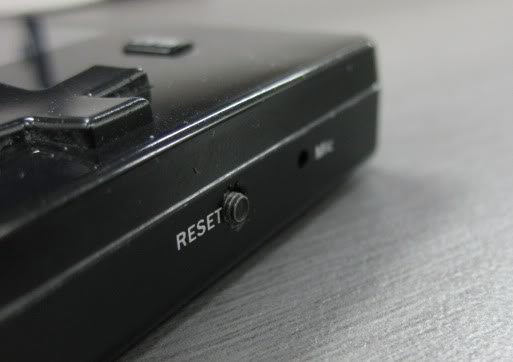

One of the earliest dingoo hacks involved pulling it apart getting a very small nail and placing it in the hole in reverse so the head of the nail was inside the dingoo preventing it from falling out. The nail was cut off just past the hole and acted as a reset button.
wow, i absolutely love the first 5 minutes on how to trim a screw... err i mean nail..
I've done the reset button mod. I left my Dingoo at work today, but I'm working tomorrow so I'll take my camera and get a shot of it. If I remember. All my gadgets at different addresses, gah!

Here's my reset button. I found the smallest screw I could in a box of junk, and it still wasn't small enough. So I had to widen the hole a little, which was hard to make neat. I don't think I'd want a thinner screw than this though, it would jab into your finger when you pressed it.
The screw head was another hurdle. It was pretty flat to start with, but it needed to be much thinner to sit in there without permanently pressing the reset button. I put a Dremel grinder bit into a battery drill (the Dremel itself is a little bit hardcore for such a fiddly job), and slowly ground the head down until it was almost paper thin. The end result works beautifully. I actually use it to turn the Dingoo on now, it's easier than the slider switch. :D
Looks good! I used a screw of the back of my Dingoo (dirty, i know :lol: ), fits great, just a tad too long. But no accidental resets since i did it months ago.
That looks brilliant Gruso. A bit beyond my mechanical abilities so I might show your post to a friend of mine and have him have a go at it.
