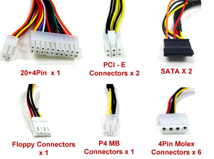

The power connector on PATA drive are white molex connectors with 12V and 5V looking like the bottom right one :

Could be. Depends on HDD's power drain. USB host gives 500 mA and 700 mA for very short time. If HDD can spin up before it will be disconnected for power overload, then it will work.so you presume i was right all along? something like this LINK would be able to power the drive as well as read from it?
ok so theres a chance my setup could work on pandora? even though its not showing up in windows pc or laptop(w/o external power)Edit : The IDE USB adapter (with a power supply block) does work fine on Pandora. Strangely an IDE drive that wouldn't work via that adapter on my windows desktops and laptop, IS working on Pandora, so my wife is chuffed I can reclaim 50gb of her stuff to another ext hdd via a hub. Yay for Pandora B)
