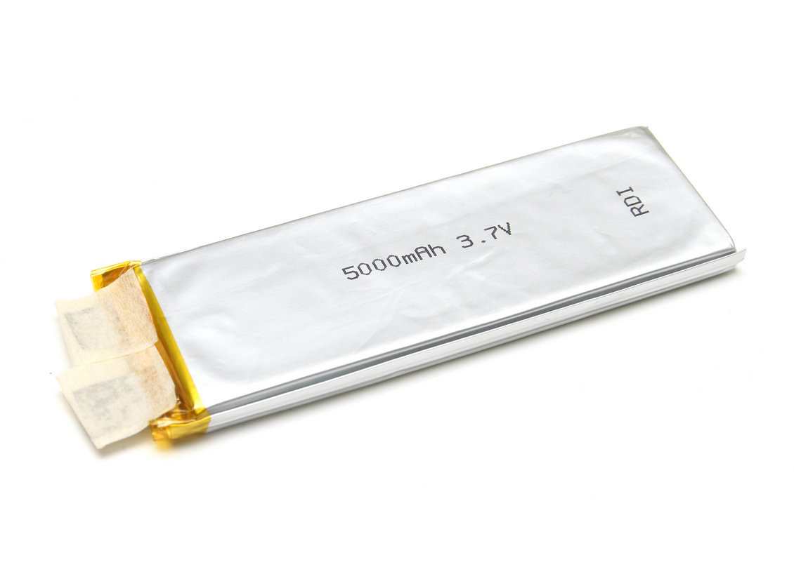

You could try to replace the lipo cell. For this you need to disassemble the battery pack, reuse the connector and pcb and just replace the cell. I'm not sure you would find a cell that fits there though... Maybe you could fit this one:
But I'm not sure you would be able to close the cover then. Careful when doing this, shorting a lipo cell may cause the cell to explode; also careful when soldering these. The lipo cell listed above is "just" the cell, your battery also has a connector and a pcb which protects the cell from over discharge. In order to assembly a battery you would need these two and the cell.

Thanks, this was the kind of info I was hoping for. I'll follow these leads. Cheers!
