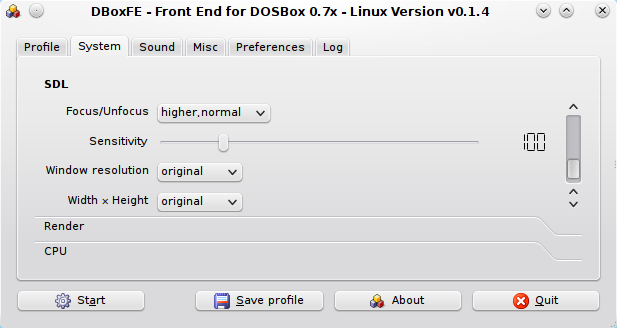

When I say the "main layout" I mean that I've redone the whole layout from scratch, and have gotten the thing to compile. I'm now working on making the layout as dynamic as possible to make it fit in as small a space as possible. Oh and I'm only talking about "dboxfe.ui"; haven't touched the others as they seem to be OK already.
EDIT: WIP screenshot:

Dude, I'm just porting the UI of an existing app to the Pandora's screen size, nothing fancy (read the first post). All creds go to the original DOSBoxFrontEnd authors
OK so here's the patch of what I've done so far (to be applied on the SVN trunk). Had to fix some code as well because of 1. compatibility reasons (it's a new UI after all) and 2. my compiler is in strict mode and didn't allow non-standard C++.
Tell me whether it's "good enough" or if I should optimize some more (I used form layouts quite a lot, and they waste space under certain circumstances)

dflemstr great job it fits just right. Right now i dont see anything that needs to change.
