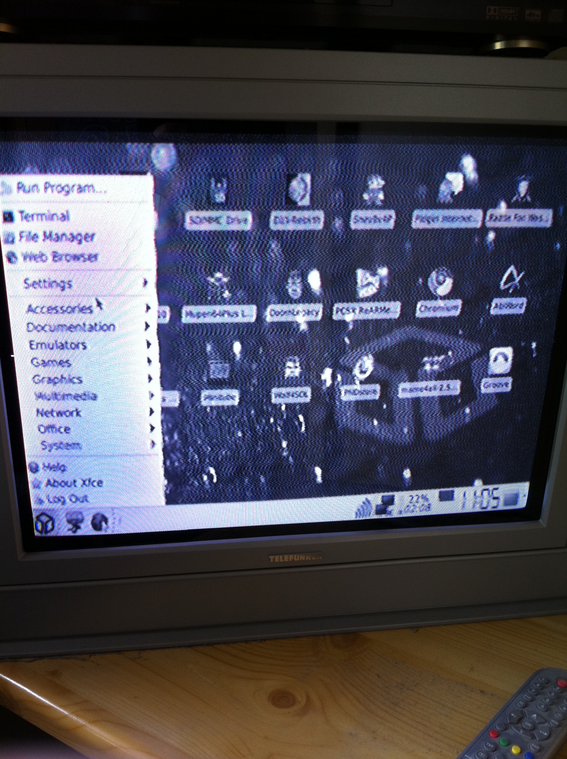

I just received my tv-out cable from peca.
I'm gonna try it out now. Probably could make some photos if you wish.
Edit: On my LCD tv screen I only get a black and white image. Gonna try it now with an old TV.
Connected via composite to my old TV it looks like this:
Edit2: Finally got it working with s-video (had to change from FBAS to YC in my TV's settings)
But composite still gives a bad black&white image.
B/W image is due to way how TV out is done. There are 2 TV out pins. TV out 1 = luminance (B/W only) and TV out 2 chrominance (colour signal) and together it gives S-Video out. AFAIK we need kernel update to be able switch TV out in composite state which gives mixed luma and chroma signal mixed on TV out 1 pin.
There could be added capacitor for mixing signals, but then is not possible to have S-Video on the one cable together with composite.
The picture distortion seems similar to the one I'm getting on my TV set. On projector (at my work) it seems to be sharp and clear (and B/W) picture. Try it on the TV where S-Video works - if possible. Other way is to use S-Video to composite adapter.

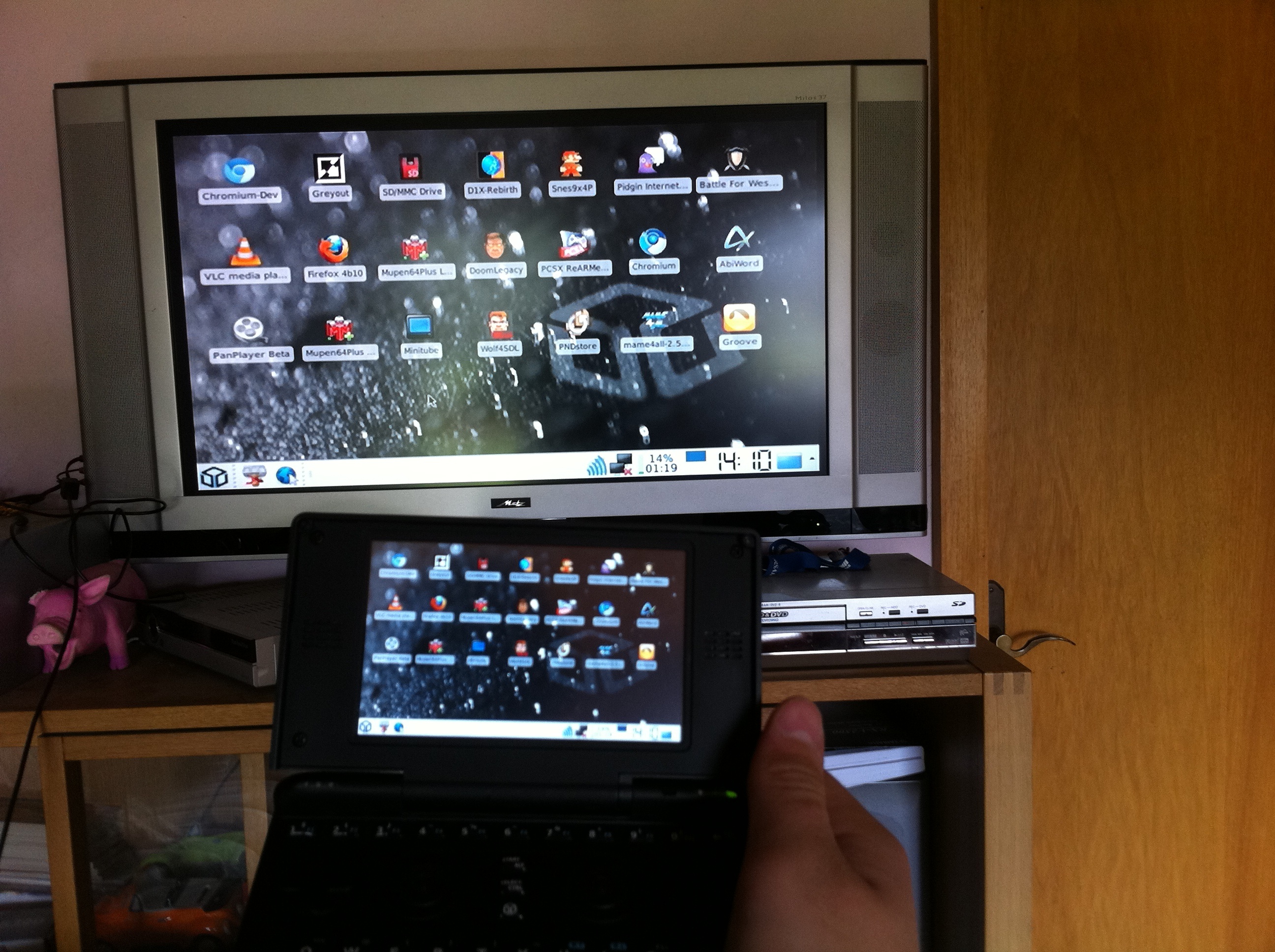

I got my TinyBoBs and Connectors not long ago. Went to a local hackerspace to get help soldering them together. Turned out to be something well within my abilities. Now I have TV out working. I am in pretty desperate need of someone making buttons over gpio pins possible.
TV out is awesome. Interestingly my north american tv gets a significantly better image with pal than with ntsc. Also, composite does not seem interested in working; sometimes it works okay (with a dark image), sometimes very fuzzy and more testing is required.
Also there is significant lag between the time something is displayed on the Pandoras screen and displayed on the tv.
