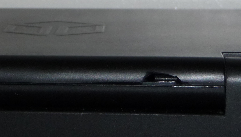

Does it look something like this?
[edit] That's on my pandora, slightly to the right of the "4" key when the display is open.
