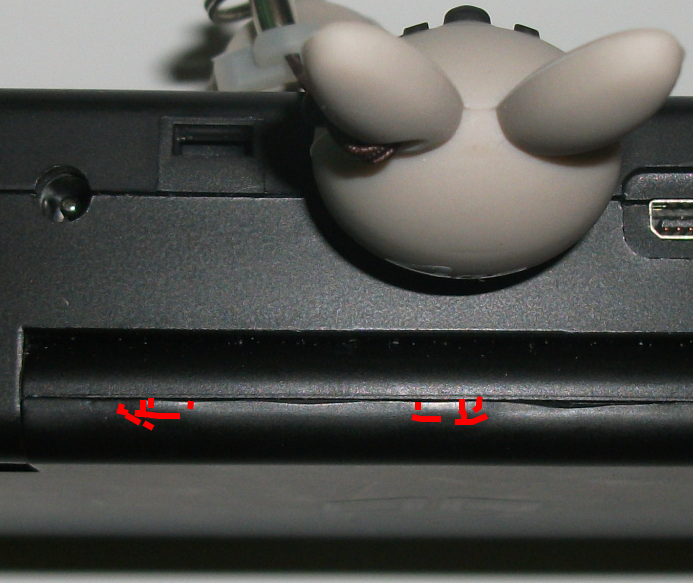

Here are the pictures - my apologies for their size.
Firstly, here are the welts and cracks on the hinge, as viewed from above.

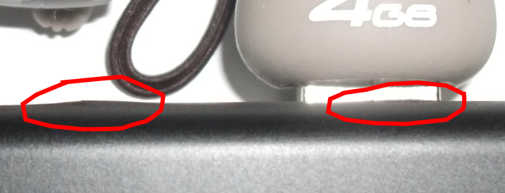

This is the welts as viewed from the front - you can see how they stick out above an otherwise flat and straight hinge. You can also see the cracks running down off of them here, but I didn't feel a need to make another highlighted picture.

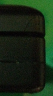

This is the corner crack. My apologies for the poor lighting in this one.

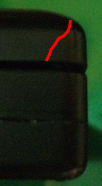

Highlighted shot of the corner crack. The crack actually continues around where the corner curves, but this can't be seen in this side-viewed photo.
I'm rather concerned about both of these, but mostly about the hinge, as today, the welts look very much like they could flake off into a bunch of tiny shards.
I'm half considering a *very* thin layer of Sugru, if I can't find a suitable adhesive to bond the ABS back together, but I'm unsure if it would be good enough for this purpose, as it would only be holding the current cracks together, and wouldn't prevent these or further ones from spreading or forming anew.
