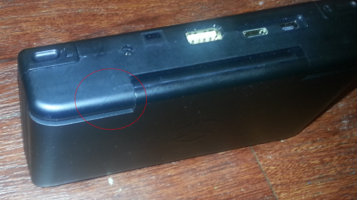

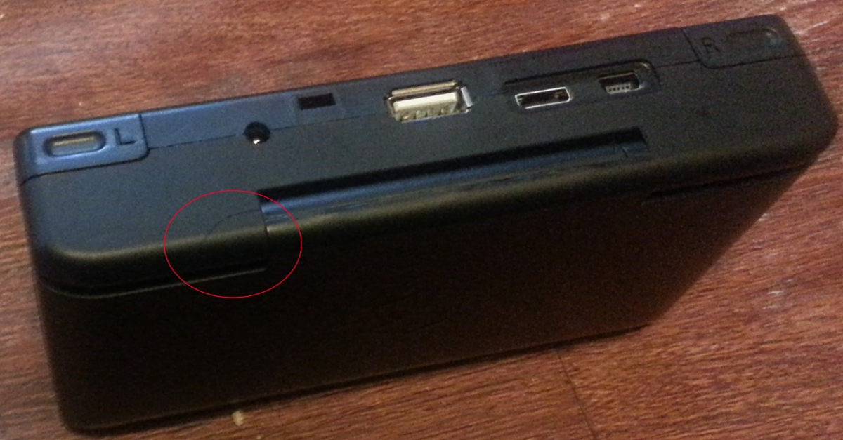

Prior to buying I knew that the black cases were prone to crack around the hinge but, I've had my pandora just shy of a month. It has developed a 1/4 - 3/8 inch crack between the L-sholder button and the hinge starting from the hinge and moving out. To my knowledge it was not there on arrival and, I have not dropped it I really thought that if I was careful I could prevent it. I bought a hardcase from ithic.com along with the pandora and a sd card to keep it in when it is not in use.
So my question is "What are my options?" Currently it is small and the hinge still functions fine does seem a bit looser than it was originally (the actual movement in opening not side to side) is there anything I can do to prevent the crack from getting worse or is switching the case to the new silver one pretty much it?
My wife seems to have my real camera But I got it to show up on my phone. Please forgive the awful macro shots.
Np, that's fine pictures... but very ugly crack. I don' remember having see one like this on these boards.
Unfortunately, this part is not easy to change.
You may first try some strong glue, but be very careful not to put too much, then press hard, and a loooong time.
I honestly haven't seen any other pictures I just see people post that it does happen with the black cases so I don't know how this one compares to others. Using a thin super glue and then maybe covering it with black tape/flexible black plastic was about the best I could think of. The crack does open up a bit when I close the screen so it probably will get worse if I leave it alone...

the milliput looks like it could be helpful to cover the crack after applying some superglue to the crack. I.E. apply glue clamp/hold until dry. Cover over that with a very thin layer of milliput let cure. Hope for the best. Do you think that milliput would stick and cure to a relatively flat surface and not peel off after it has cured. As in do would it adhere to the plastic. I've never used sugru or milliput so I don't know how the work really.
