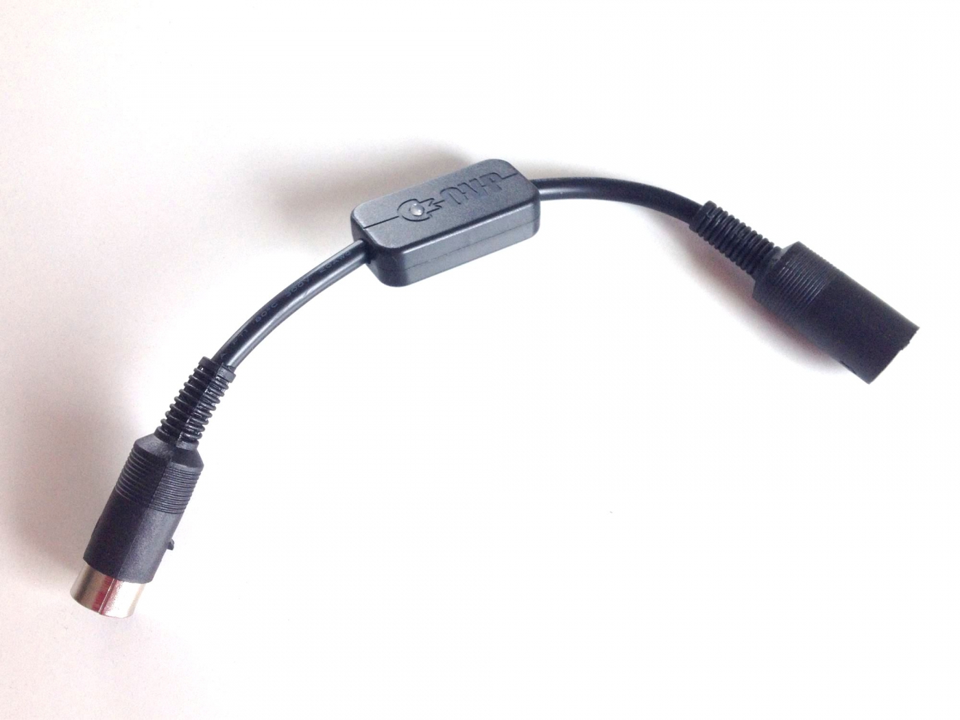

or maybe get this overvolt protector. minor issue, it costs somehow the same as a new psu. xD
problem with the original psu's is that they do not fail gracefully like most other psu's out there, but will overvolt the board when failing.
nevertheless for a short testrun it is ok to use the old psu as it is, i would say. (if it's not known broken, of course)
ah, and the psu is external, no need to open the computer.

here is an explanation, i think they work all more or less the same
This over-voltage protection unit is designed to prevent damage to the Commodore 64 computer due to a failing power supply. One of the ways the Commodore "brick" power supply can fail is from a shorted internal 5 volt regulator. That fault puts excessive voltage into the computer and damages chips such as RAM very quickly... and silently. The Saver protector is essentially a fast-acting electronic circuit breaker. It functions to quickly cut off the 5 volt supply line to the computer if the voltage exceeds about 5.4 volts. It is not a "crowbar" device but opens the line from the supply to the computer before the voltage gets high enough to do damage. That's the safest way to do it. After-market power supplies, even switching types, can fail at any time. Switchers are more reliable and much less prone to catastrophic failures but can still cause damage to the computer if they fail. This Saver is designed to protect any computer that uses the standard Commodore "brick" power supply as well as any newer switch-mode PS. Computers include all versions of the C64, the later CR version of the VIC20, and the Plus/4. Because of its square power connector, an external Saver is possible for the Plus/4 but its power socket would have to be changed to the round C64 version because four pin square DIN connectors are not available. - Ray Carlsen
source: https://github.com/SukkoPera/OpenC64Saver
