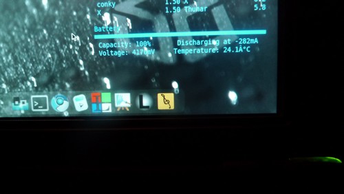

hi
seems to be working i attach a pic of Pandora plugged into charger at 100 percent charge - no red light;
will test in low power mode and report, btw am running HF4, will test in HF5 as well
edit
if you unplug charger (at 100 percent charge) and replug charger the red light comes back on
That's normal. Once you've unplugged it it loses the "I was charged" state, so plugging it back in automatically starts it charging again. Close the screen, give it another few minutes to top up again, and it should shut off.
And yes, I meant you'll have to run this after every reboot, but only once per session.
on HF5 does not seem to switch off red light?
how long after reaching 100 percent does it switch off red light?
It varies from battery to battery. Might take a couple minutes, might take up to an hour. If it's consistently taking longer, I'll tweak the value up so it stops sooner. The drain on the battery has to drop low enough for it to detect a full charge, though, so the light may not go out until you put it into low power mode, or at least shut the lid so the LCD turns off.
