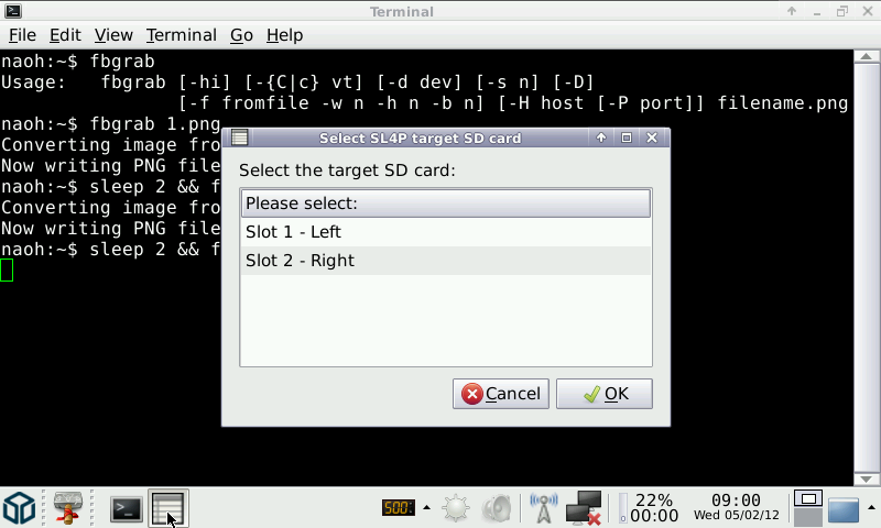

2- And another question, how to i know which slot is used ? mmcblk0 is the first card inserted, but i would like to know if it's in the left or right slot.

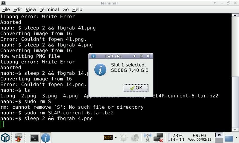

Some progress here, i figured out how to know which card is where.
It was pretty simple, reading dmesg, mmc0 is the left slot, and mmc1 is the right one.
I continued to write the pnd. I now need to polish it a bit, enhance some things and fully test it.

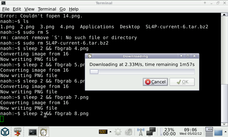

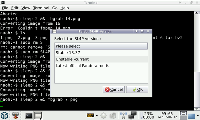

Ok a new version again.
Can also download and install the latest pandora-rootfs.

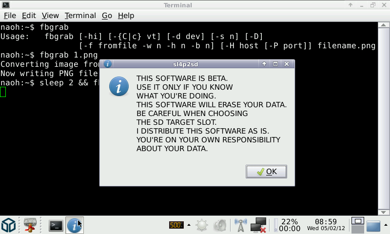

I'm currently enhancing the security of my app, which already works pretty well.

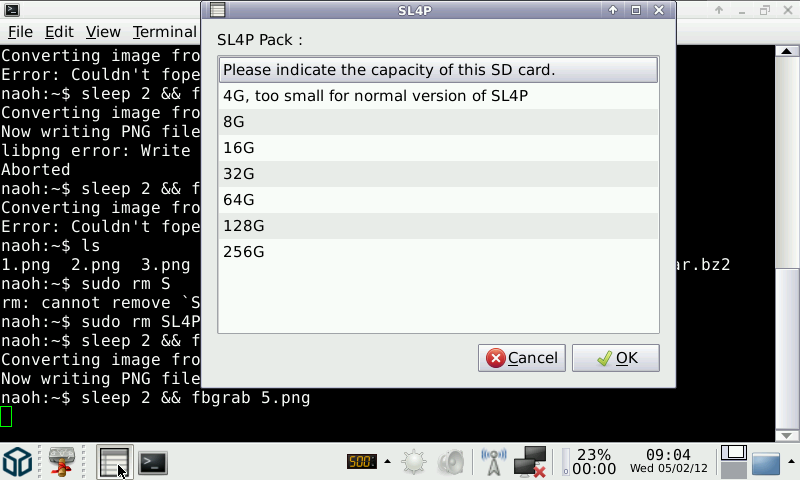

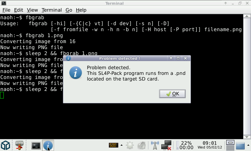

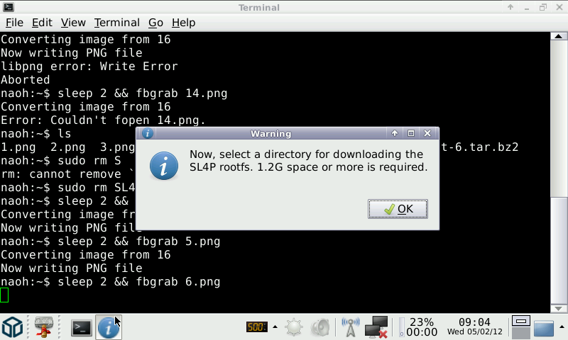

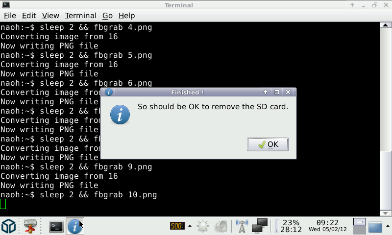

Some screenshots:
