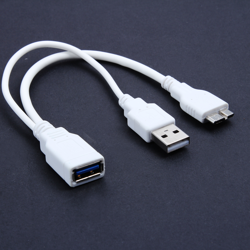

Well I just ordered this to try out on the Devboard which should work similarly on the Pyra, I also suspect to use anything meaningful a powered USB 3.0 hub should be used.

Well, I have one drive that is in a mSATA case but it only has USB 3.0 cast, the other SSD is in my notebook and if I can edit video well enough on the Pyra then I'll take the 2.5 SSD out of the notebook and sell it. I have a y-cable, one side plugs into the drive and another lead that plugs into a battery so I could do that.

This is what I was thinking, can only have one device at a time but it takes up less space.
Then I could just use the power bank for power.
