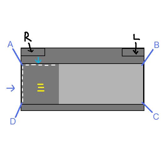

Does anyone have a picture of exactly how the battery is shimmed? I've tried a number of thing and none of them are giving me a reliable battery readout. I also don't know if it is charging properly. The last time I tried charging it after 2 hrs it had not even gone up by 10%.
Using my fine art skills, here perfect rendering of the back of the pandora, the lighter section is the slighty raised section of the battery and the 3 yellow lines are the battery contacts. L and R are the triggers and I've labeled the corners to make talking about this clear.
The dashes are where I've tried putting shims, along AD and part of AB, but I still have yet to get the battery to report any drain while I'm using it (not plugged into the charger, of course).
Which side is the correct side or should I have shims on both sides? Should AB go the entire length? Or am I doing it all wrong?
Nice diagram :) I would have thought a shim from BC and perhaps AB would be more useful, so as to push the battery against the contacts from the edge farthest from them BC and prevent any front back movement with the AB shim. Other than that some paper between battery and cover to press vertically aswell incase your battery is on the slim side and can drop away from the contacts at all. Hope you get sorted eventually, as it must be a pain.
