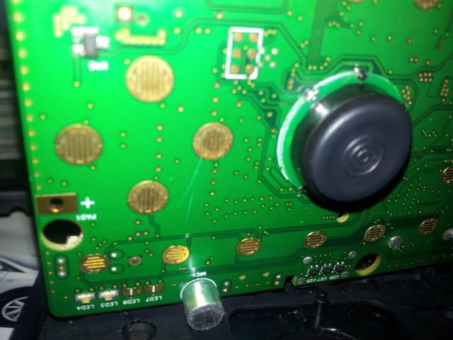

Hi all,
I have tried the input tester pnd and confirmed that the B button isn't registering presses. It was working then just stopped. Everything else is working fine.
I don't want to send my pandora for repair so any ideas I could try will be gratefully received.
I haven't opened it up yet but I can give the contacts a clean if it would be worth a try? It's all I can really thing of doing.
Thanks!

You can get at the key-mat easily enough you just unscrew the base and move the PCB.. the only thing you need to watch for is the LCD cable it's delicate.
My guess there is an issue with the conductive pads on the DPAD area of the key-mat it could be dirty of missing the conductive part.. If cleaning doesn't work you can just order a Keymat from the dragonbox.de shop..

If you can't see any obvious issues with the PCB or keymat and simply reseating the keymat it doesn't fix the problem it may be worth rubbing a  graphite pencil over the contact surface on the keymat.

Well, I have good news and bad news to report after I gave the pad and the pcb a wipe with a cloth and some contact cleaner.
The good news is that I don`t seem to have caused any harm to my pandora opening it up, Everything that was working still is. I noticed that the screw nearest the power switch was pretty chewed up when I went to loosen it but it still turned so no problem.
The bad news is that the B button still doesn`t work.

The new keymat arrived (fantastically well packaged and protected in a big box full of bubble wrap) and I changed the mat over.
B button still not working. I cleaned the pcb contacts again and had another go but still nothing. The contacts look intact.
Is there anything else I can check or do?
