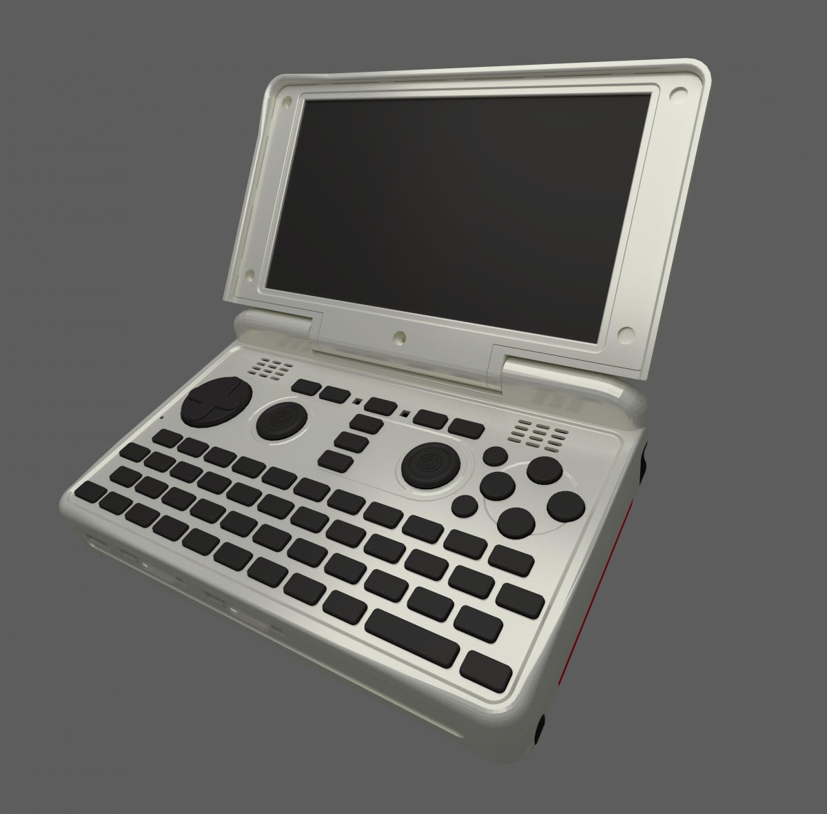

1. The Case design
The case design is basically finished.
The only thing left is to print it, test it (together with the prototype PCBs) and make some final tweaks in case something doesn't fit properly yet.
Then it's time to produce the moulds and two months later, we can start producing the case.
During that timeframe, we can also choose the colors (together with the community, of course).
I will probably publish a Blender file so everyone can work on color designs as well!
I've rendered a few pictures for you.
Don't worry - weird stairs-like artifacts you can see on the case are due to importing a CAD file into Blender - the Mesh had a too low resolution.
In reality, these curves will be perfectly smooth.

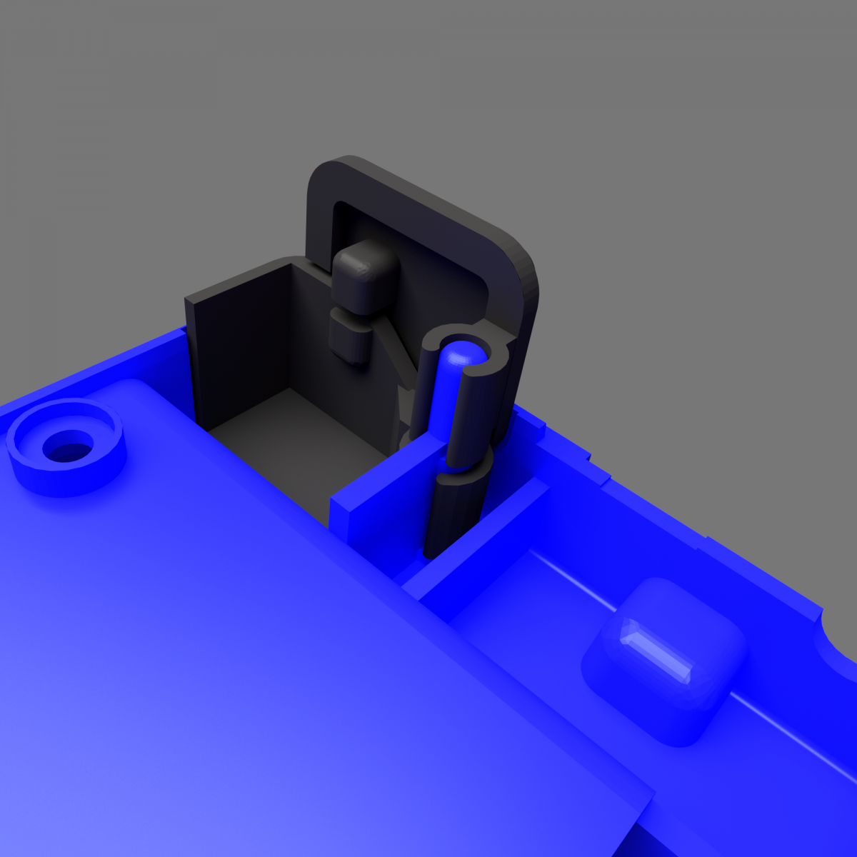

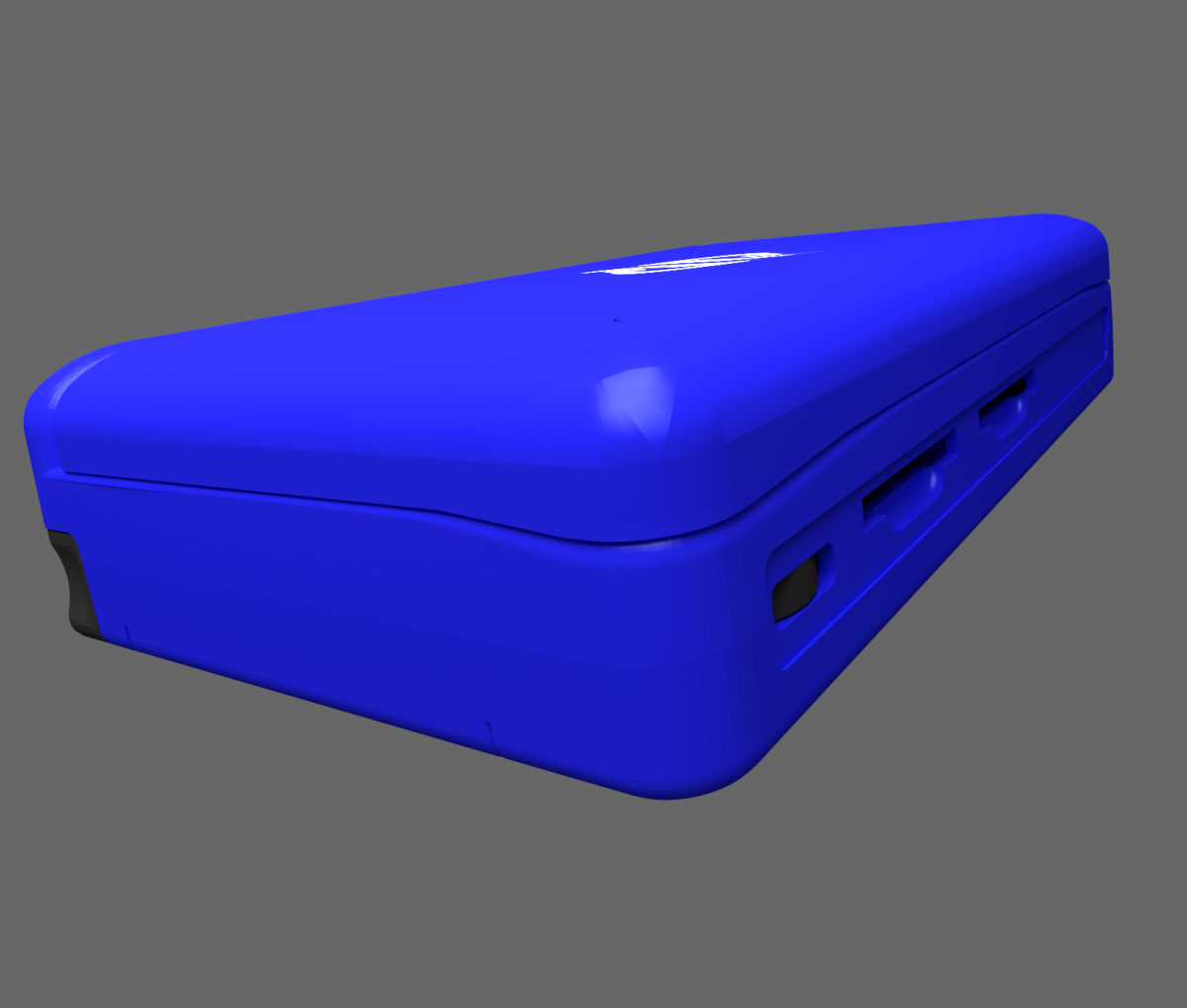

Now, what changed for the case since the last time I posted?
The edges where your palms hold the device have been rounded.
This should make playing a lot more comfortable.
The lid edges will have the corners changed to be slightly rounded in order to fit there.
You can easily see that in the picture here.
On this picture, you can see the new rounded lid on the left side and the old (not rounded one) on the right.

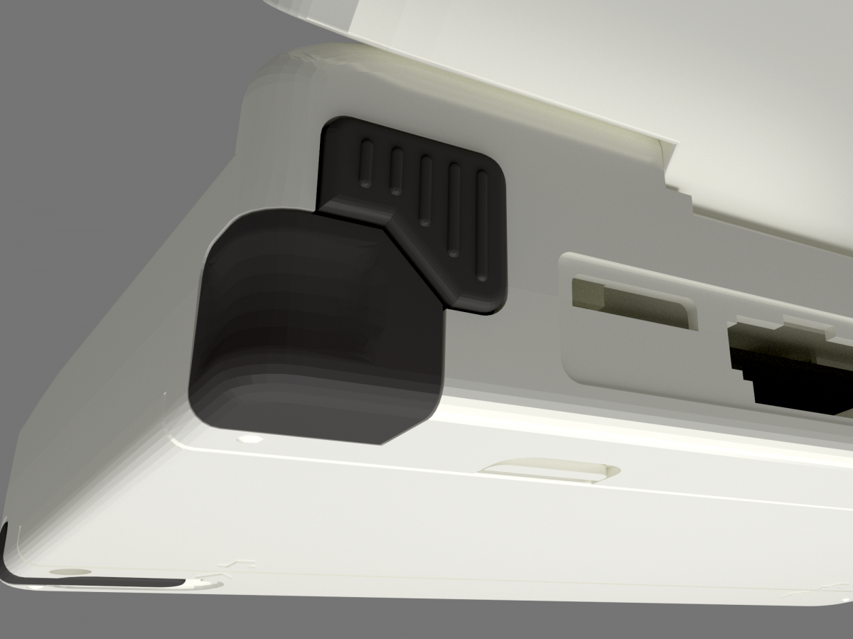

The shoulder buttons have been slightly tweaked so that the upper button has no dead spots (where you can't press them).
Some minor change (just cosmetic):
The front has been changed to look a bit more symmetric.
I can't wait for the printed case :D

1.) Das Gehäuse-Design
Das Gehäuse-Design ist grundsätzlich fertig.
Es fehlt nur noch es auszudrucken, testen (zusammen mit dem Prototypen PCB) und Änderungen, falls etwas nicht passt.
Danach ist es an der Zeit die Formen zu produzieren und zwei Monate später kann die Produktion des Gehäuses beginnen.
Während dieser Zeit können wir auch die Farben bestimmen (zusammen mit der Community natürlich).
Ich werde wahrscheinlich eine Blender-Datei veröffentlichen, damit jeder an den Farben arbeiten kann!
Auch habe ich euch ein paar Bilder gerendert.
Keine Sorge, die seltsamen stufenähnliche Artefakte, die ihr sehen könnt, sind beim importieren in Blender entstanden, das Mesh hatte eine zu kleine Auflösung..
Die Rundungen sind in Wirklichkeit komplett rund.
Was hat sich nun seit dem letzten mal verändert?
Die Ecken, an denen die Hand aufliegt sind nun abgerundet.
Das sollte spielen angenehmer machen.
Die Deckelecken sind auch angepasst, damit das zusammenpasst.
Ihr könnt das in dem Bild einfach erkennen.
Hier seht ihr die gerundeten Ecken links und die alten Ecken (nicht gerundet) rechts.
Die Schultertasten sind auch leicht verändert worden, damit die obere Taste keinen toten Punkt hat (wo man ihn nicht drücken kann).
Einige kleinere Änderungen (nur kosmetische):
Die Front sieht nun symmetrisch aus.
Ich kann das gedruckte Gehäuse kaum erwarten :D.
