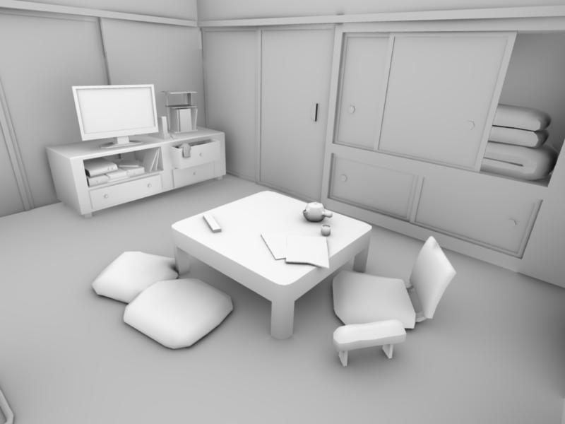

Well, I noticed that this thread has gotten over 3000 views... I guess its time to show some work.
This is the apartment interior. The shading is done using Blender's ambient occlusion (which bakes wonderfullly). I hope to bake the lights using the upcoming Lightcuts implementaion.
Poly count wise, the entire apartment so far is comprised of approximately 8000 triangles. The meshes themselves are at a midpoint between hi-poly and being optimized for low-poly. Once we understand what the hardware will be able to handle, I will be able to scale in either direction quite easily.
In terms of actual 3D engines, I am working with a person who is developing one right now. However I will leave it to him to discuss the details of his engine.
It seems you used the fast, fake AO, which is great for animations, but I think full AO is better for baking.
Totally agree on that part. Aproximate AO is good for quick renders (such as this) however Raytraced AO will definitely be used for the final bake.
cb88 said:
is that a teapot!?
Yep, that's a tea pot.
Wow, nice room. What did you have used for a light setup to get such smooth and real looking shadows? I always fight with Blender to get a good lightning, maybe I should try the new 2.48 version. I've also played with ambient occlusion in the past but it is very CPU intense and Rendering onto my 1.1GHz Athlon XP is FAR AWAY from fast. :D And high sample numbers with AO need heavy CPU calculations, low sample numbers result in "noise" etc...
...I really need a new PC :lol:
