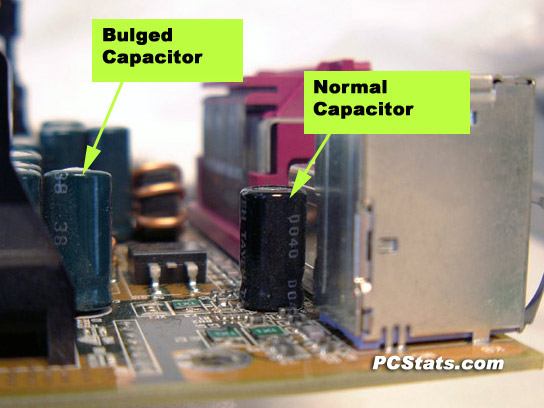

Open your computer and look on the motherboard for leaking capacitors that look like this:
or this:
Senor --

euro48k said:
hehe ..those are old computers..
present days are better :)
He never said how old his computer was and there are still plenty of old computers still chugging along that have some bad caps on them. In fact, my friend has a Soyo Dragon board that still works just fine and it has a whole row of bulged caps. Wouldn't want to use it as a server, though.
Reason I suggested it was as a PC tech I saw several PCs exhibit this same behavior. Worked fine until you plugged something into a USB port while it was running. But if this SP3 linux inf thing is a new problem I'd agree it's probably more likely.
