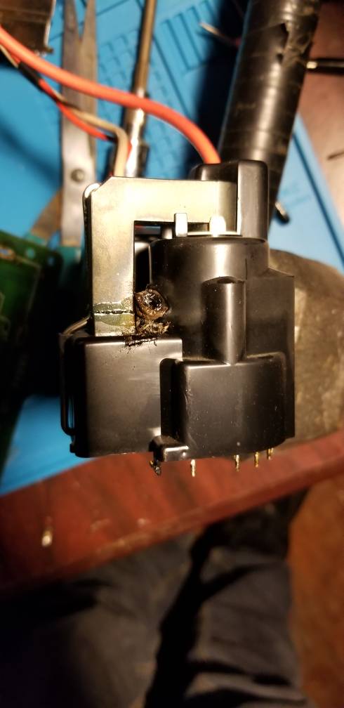

Kinda hard to find a replacement, but $84 later I have one coming
