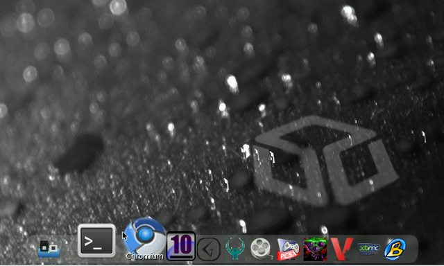

This is great, thanks! It looks so much better than the pic in the OP suggests (think minimal with transparency). [edit] Picture in OP looking much better now. ^_^
With the right customisations it could be very finger friendly. I've got some tweaking and screenshotting to do.
One little bugbear; when you click to select an icon for a new item, it opens /mnt/tmp/wbar/share. It should take you to the XFCE icon library (wherever that is). Scratch that, I decided to read the OP in full. >.<

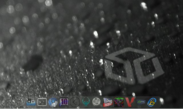

Thanks, would be great to have an actual screenshot of the bar in the description here.
Would be good to have an actual pandorascreenshot in this topic.
Skeezix: Thanks for pointing that out!
That looks good, better, if the mouse was over the bar to show the zoomeffect ;)
