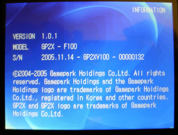

Here's mine (I've got a skin on it so it's blue) mine's unit #132, I'm guessing it was initialized on the 14th.
I upgraded the firmware and now it says version 1.0.1
Hope this clears things for people.
Oh, by the way, flashing my firmware didn't work at first, I had to reformat my SD card in windows before the card would work. I have a normal SanDisk 1GB card. Once I did that and put the upgrade on there as it boot it gave me the Upgrading Firmware screen... then once that worked I ran the patch that's included.

Well, in that picture you showed, the 1.01 firmware hasn't installed yet, since your battery light is still on... once the 1.01 version is in, the light turns off.
It's quite possible that the in the version of the firmware installed at the factory the version number was broken, there seem to be many fixes in 1.01.

I had mine showing version 1.0.0 until I ran "patch20051128.gpu" in the utilities section.
You have to put all the files from the new 1.0.1 firmware .zip onto an SD card.
The IMG files aren't needed.
Then when you run "patch20051128.gpu" in the utilities menu you should get the new version number.
Just a hint, make sure the file "version" makes it onto the SD card
