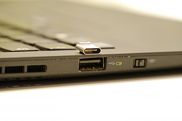

http://gizmodo.com/sandisk-has-the-first-flash-drive-with-a-reversible-usb-1688533182
Best of both worlds by SanDisk?
Usb3.1??
