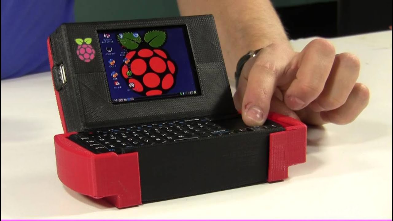

For comparison, the Pyra is probably going to cost £370 or so. Much of that cost is down to the difficulty of fitting so much hardware into such a small box.
If you want to use standard parts, bundled up into a portable device, you'll end up with this:
