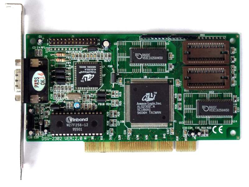

I include an image to explain a little better (note:example only)
http://www.ixbt.com/short/2k3-09/ali-4.jpg
See the Black chips they are ram
The brown sockets are for extra ram
if you had some spare brown sockets you could slot them on top of the ram already on the board giving you access to all those pins without having to do any soldering on the original ram
