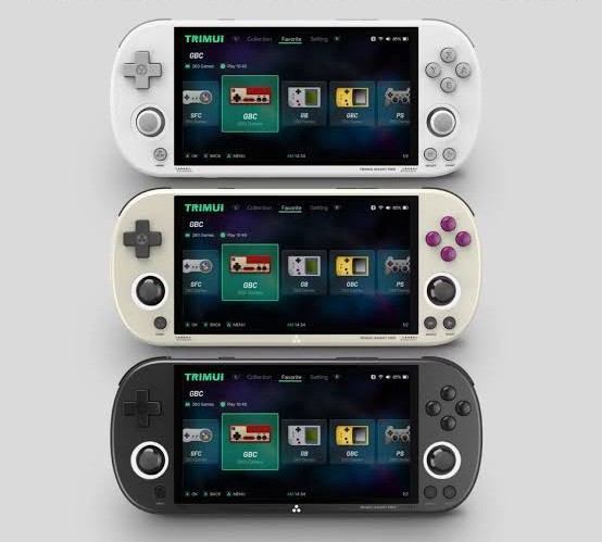

Hi I bought one of these handhelds for only $55. Its actually turning out to be a decent and fun device. The device has a cross compiler released, supporting GLES1/2 and Vulkan,
Its using a Allwinner quad core. Based on a clock switch it overclocks to 2 ghz. It has a PowerVR GE8300 for the GPU. The screen is 1280x720. Runs linux (havent seen kernel source yet)
Really gives some nostalgia for the GPH devices.
I already have my hurrican port working with two builds with SDL1+EGL and SDL2 so development shouldnt be hard. It looks quite nice. It still has some rough edges. Id like to get around to doom, quake, etc.
But I plan to post port links as Im happy with them here in case someone else happens to have one. Unfortunately seems most of the discussion for these handhelds is on reddit and i dont want to post there.

I Love mine <3
They're very different in almost every conceivable manner, but I really shouldn't judge it until I get one next month.

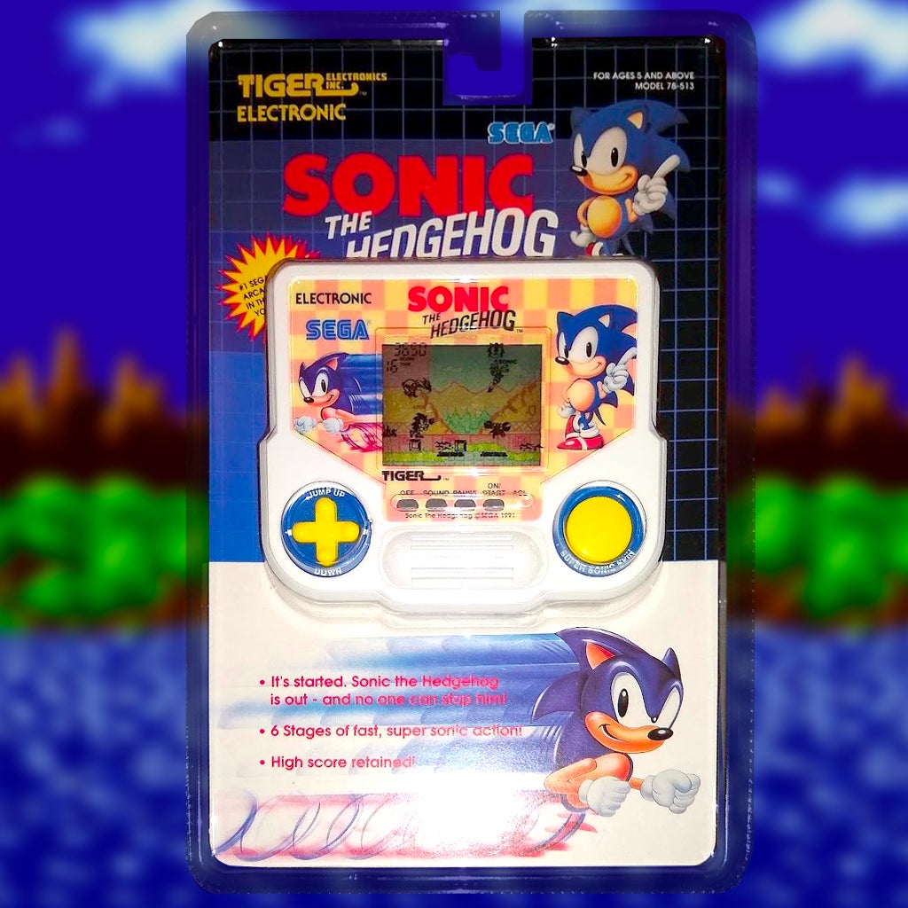

In the past we only had these things and this example is already a fancy looking version:
This got replaced with some handheld which have some cheap RockChip CPU inside running Linux or Android. So while I understand we don't want hundreds of similar cheap products, more affordable retro-gaming handhelds running Linux should be a good thing.
