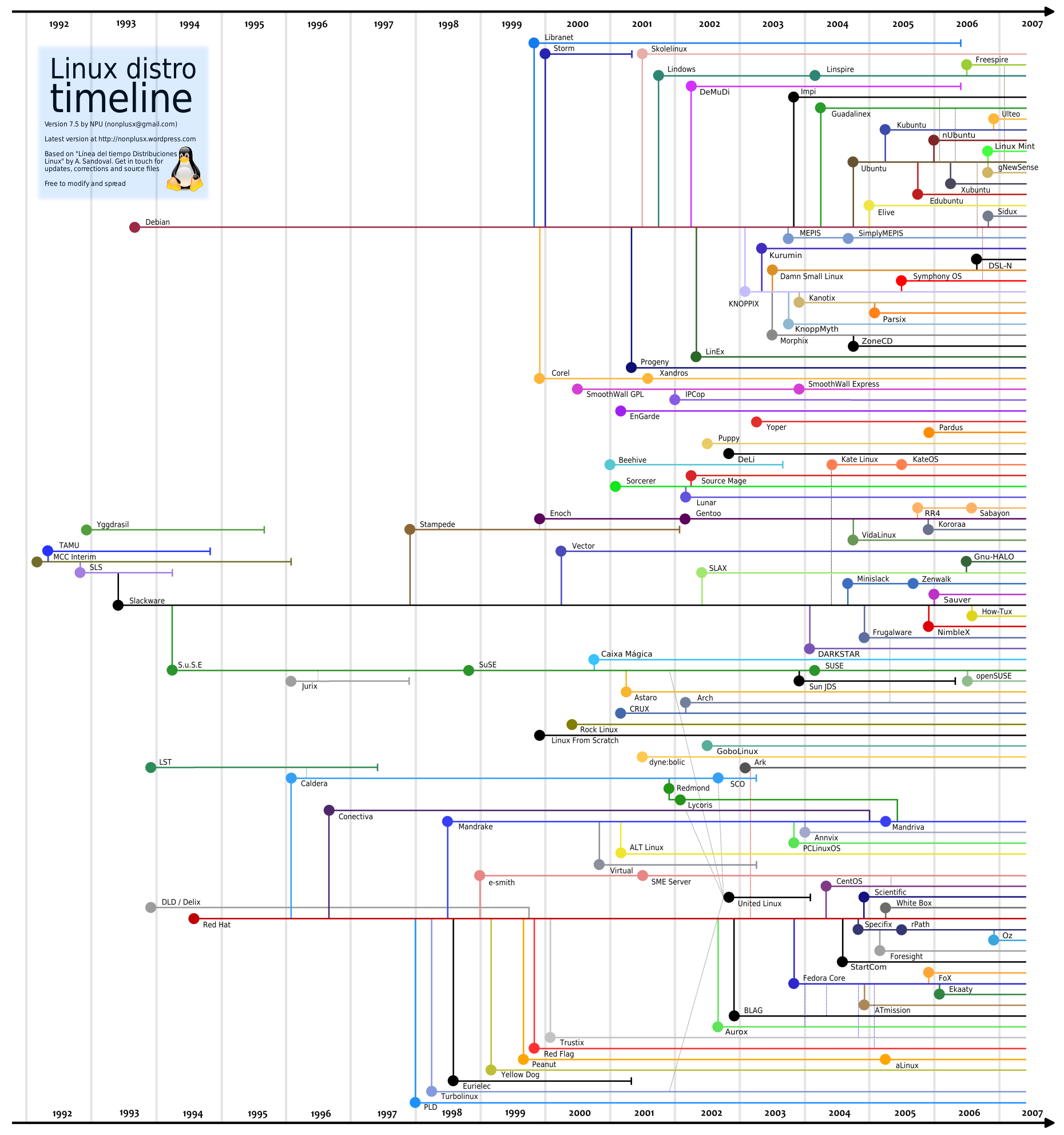

I am very thankful for their services to the world, but it has always fascinated me that there are so many individuals who care so much about what I see as very minor differences in nearly identical distributions that they devote thousands of person-hours to the effort of maintaining each of hundreds of different distributions.
Apparently these subtle differences are highly important to some. Personally, I'm generally good with a plain old Debian install. Last time I even installed all of the DEs that ship with it (just for fun).
A lot of the fragmentation is good for Linux in general - more eyes being picky about more things means more upstream submissions around bug fixes. Some of it, though, gets into a bit of silly overkill.
https://linuxhere.files.wordpress.com/2010/08/lintimeline1.png
