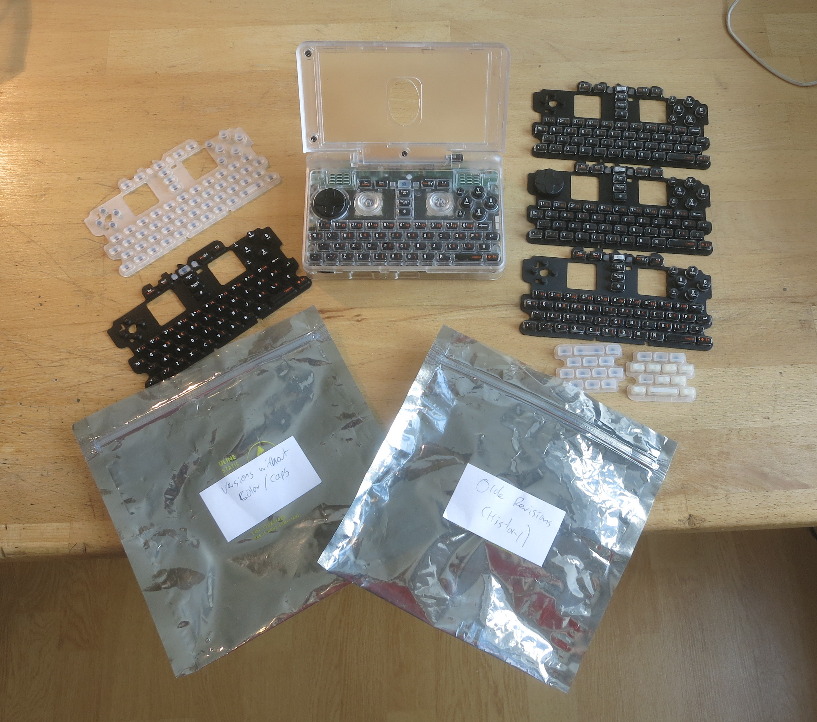

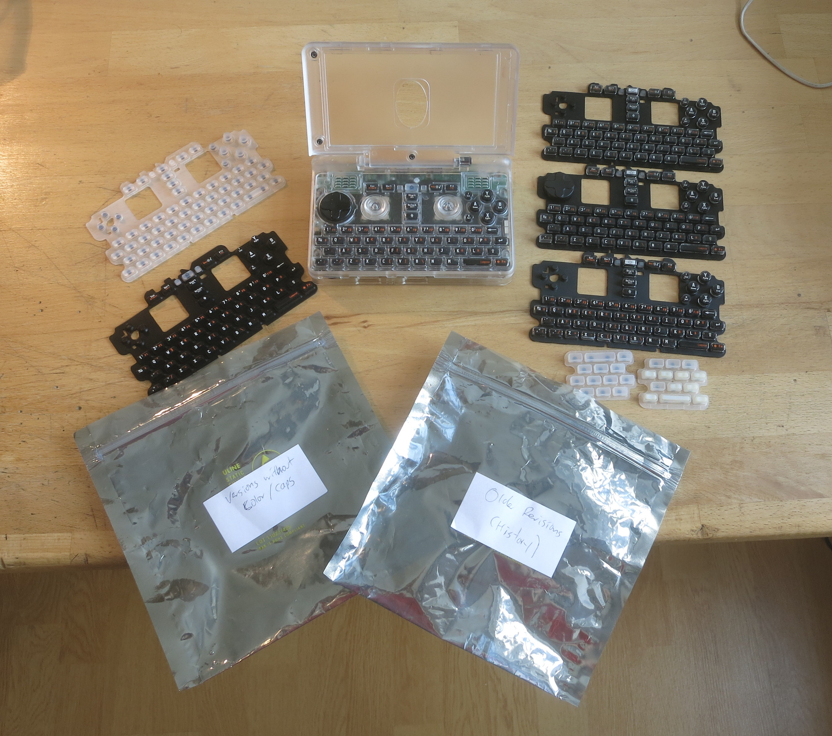

What's in the box?
A Pyra without screen, battery, stylus, CPU board and speakers.
One bag containing the current keymat without keycaps and without color
One bag containing five older revisions of the keymat.
Controls:
I figured @EvilDragon wasn't happy with the DPAD on the current keymat, there's a better one on an earlier revision.
The nubs feel a lot better than on the Pandora. They're even clickable! But only in the center position, it seems.
The shoulder buttons are in pretty good positions. The mainboard doesn't seem to have the right buttons soldered, though, so I can't say how they click.

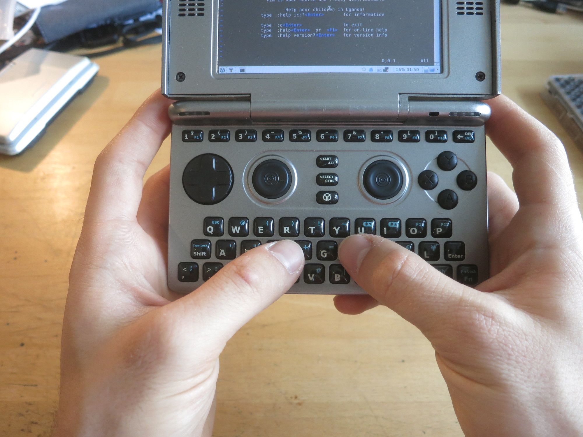

As I said, I like typing on the Pyra keyboard. The keys are easy to press, have a click and you can easily move the thumb from one key to another but still distinguish every key. I really missed this on my smartphone.
(And while my fingers need to really press together, in theory I could touch type with 8 fingers.)
Also, I'm still in favor of a one-wide spacebar. I'll mod that the second I have my own Pyra :D

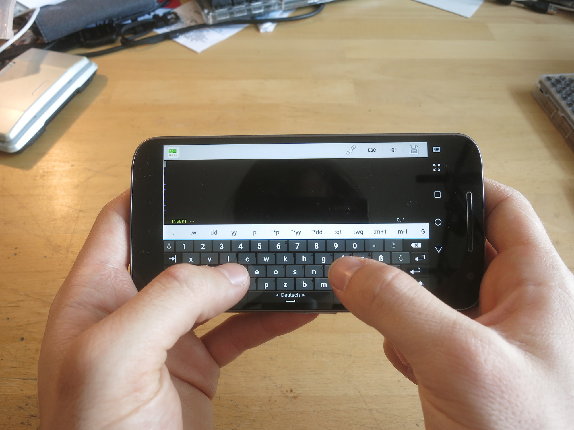

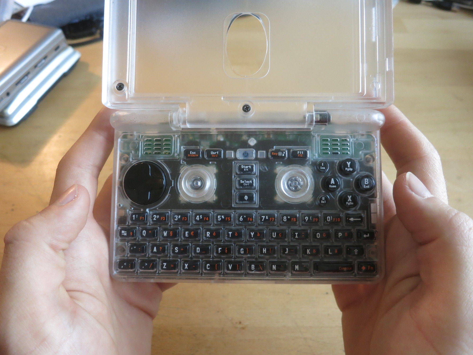

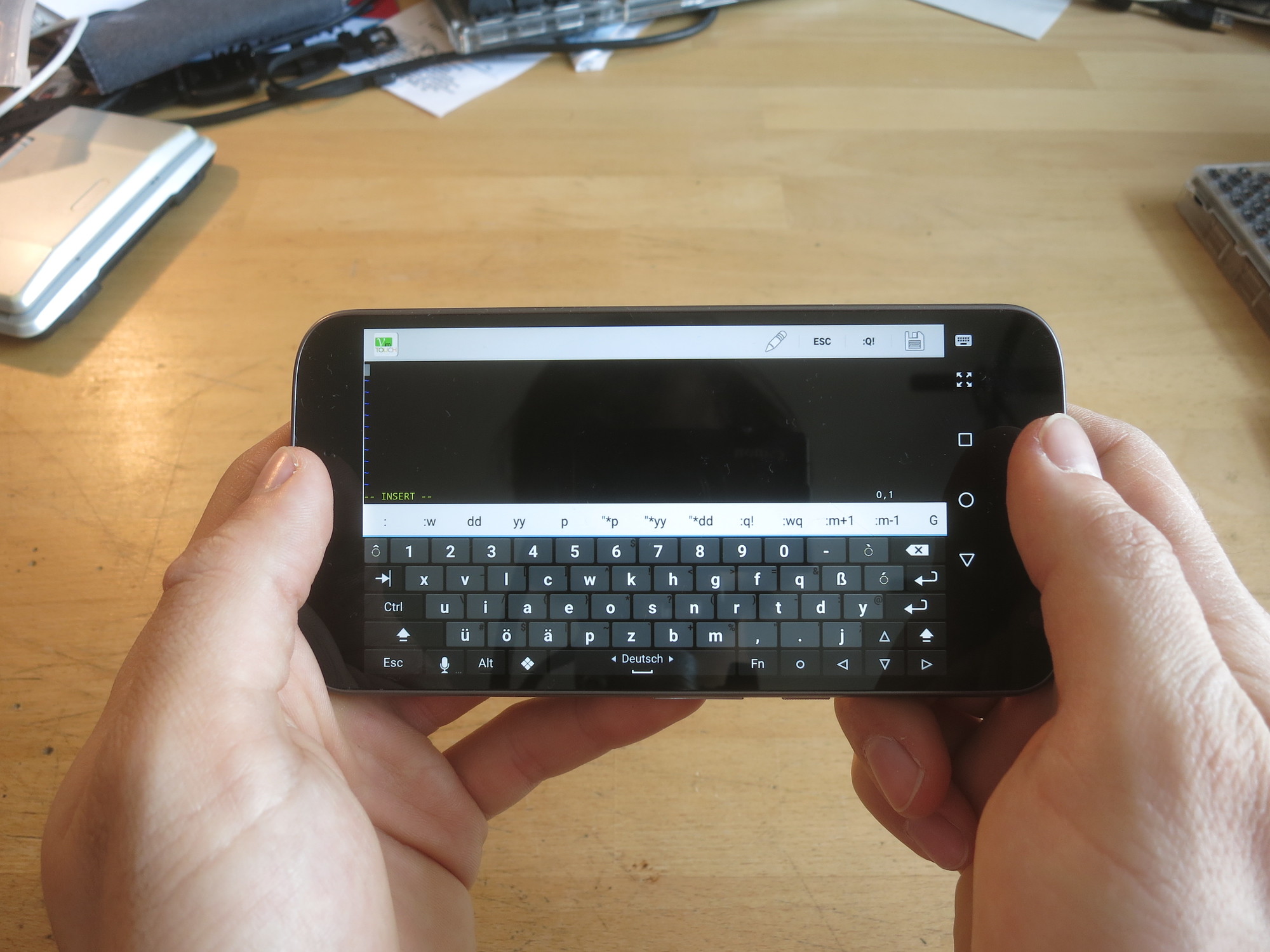

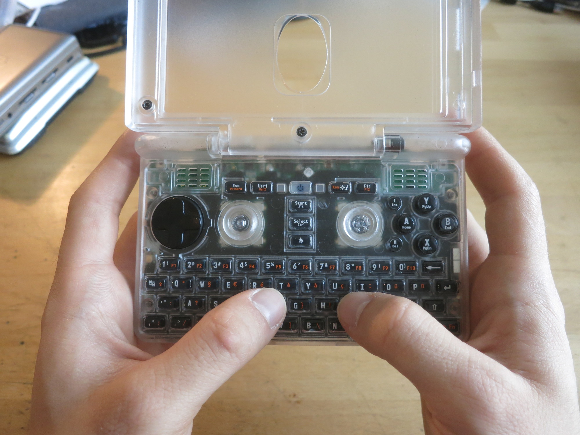

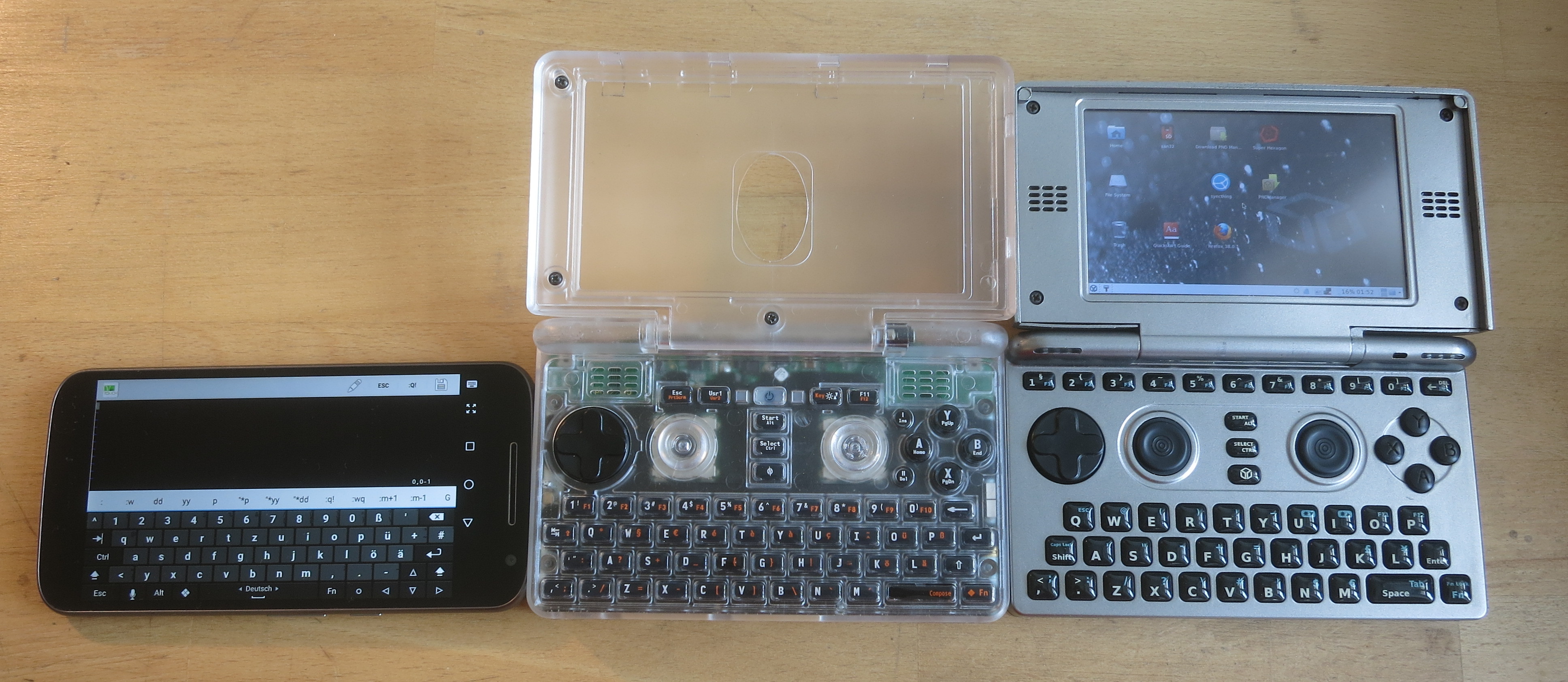

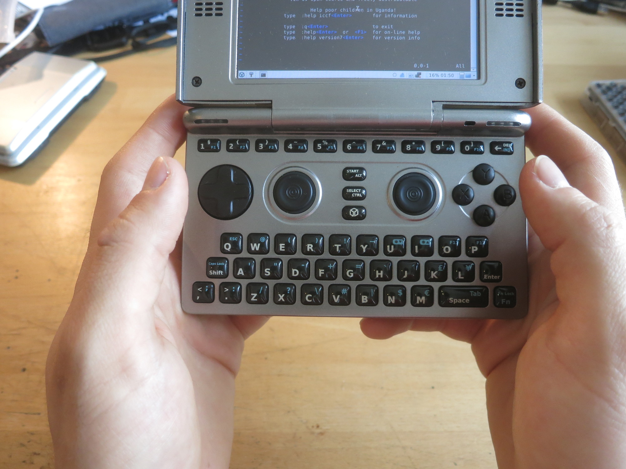

I took a few pictures holding the Pyra, Pandora and my Smartphone in typing position. Maybe that helps some of you get a better estimate of the keyboards:
All three devices with their keyboards:
5.5" Smartphone:
Pandora:
Pyra:

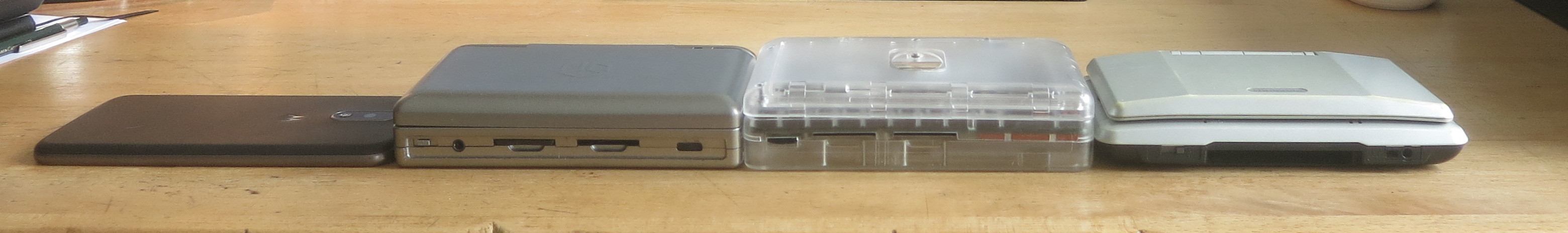

Thickness and pocketability:
Here's another height comparison:
The Pyra fits into the front pockets of my jeans, but not at all comfortably. The Pandora is a bit better, but both stretch my jeans a lot when moving.

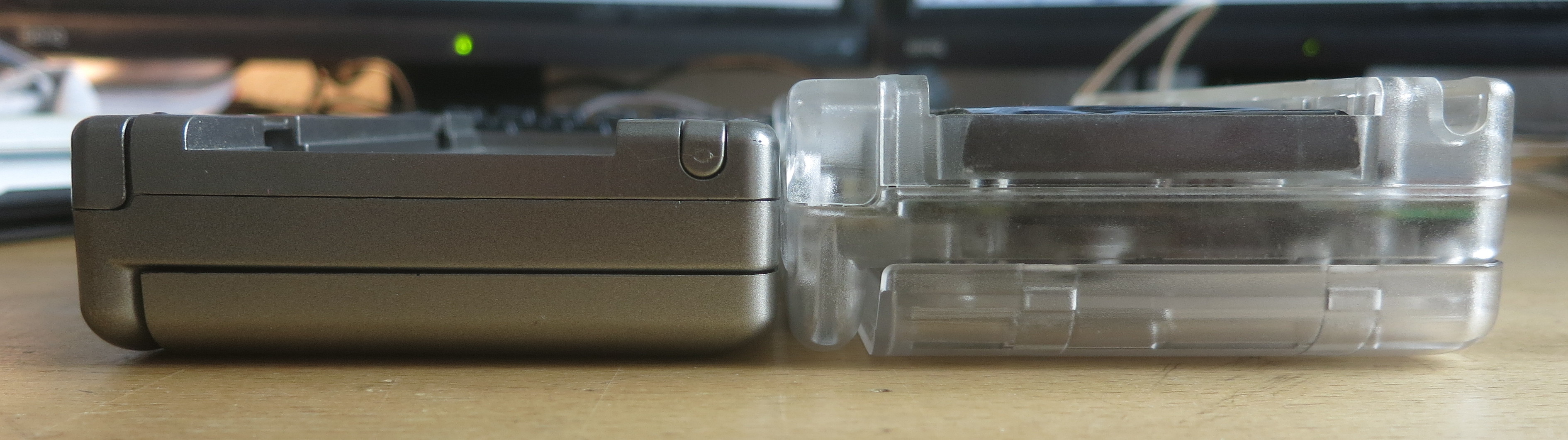

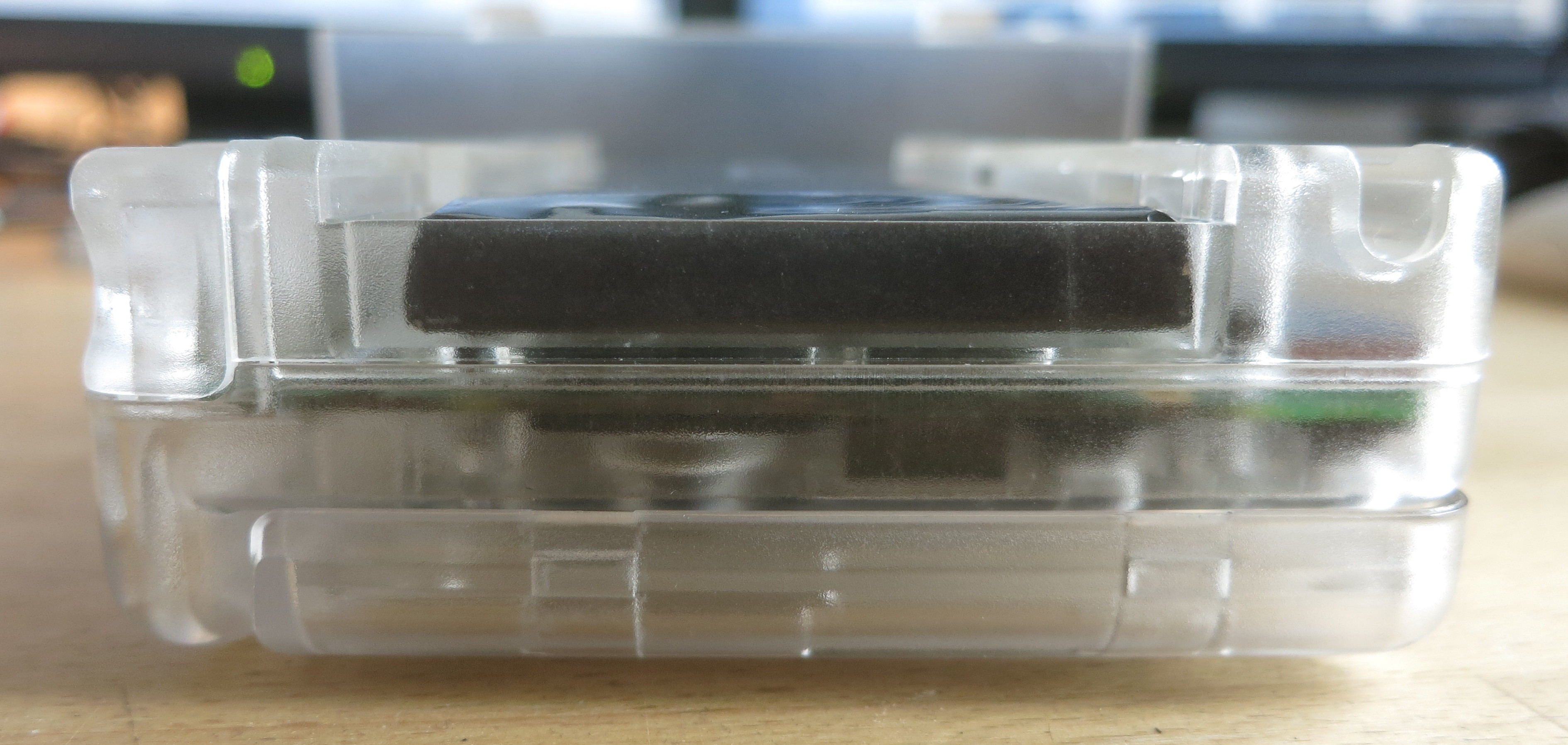

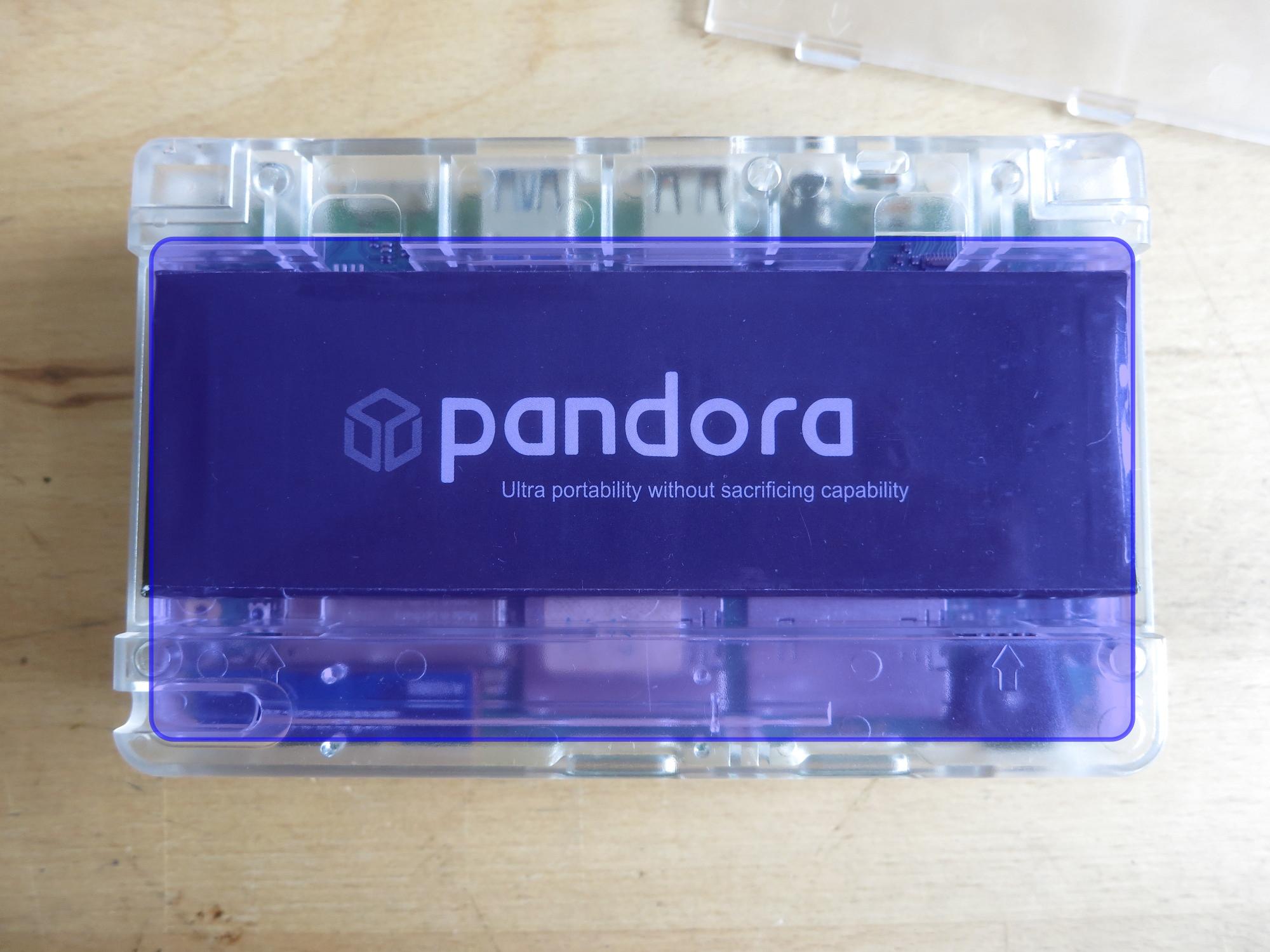

That said, I have the feeling the battery compartment could be half its current thickness, at the cost of either: A smaller battery or a screwed on battery lid.
The Pandora battery has a lot of clearance:
With a battery of that thickness, you'd have the thickness of the Pandora:
I've been thinking about having a battery of basically the whole area of the Pyra:
You'd lose the stylus and probably need a battery compartment that's screwed on instead of clipped on, but the battery would still be replacable. (I.e. not soldered in, but you'd need a screwdriver and 2 minutes of time instead of 20 seconds.)
BUT! It would be a pretty big battery in a thinner case. Maybe I'll play around with the case files and print a bottom case with this configuration.
I bet it sounds a lot easier than it will be in the end…

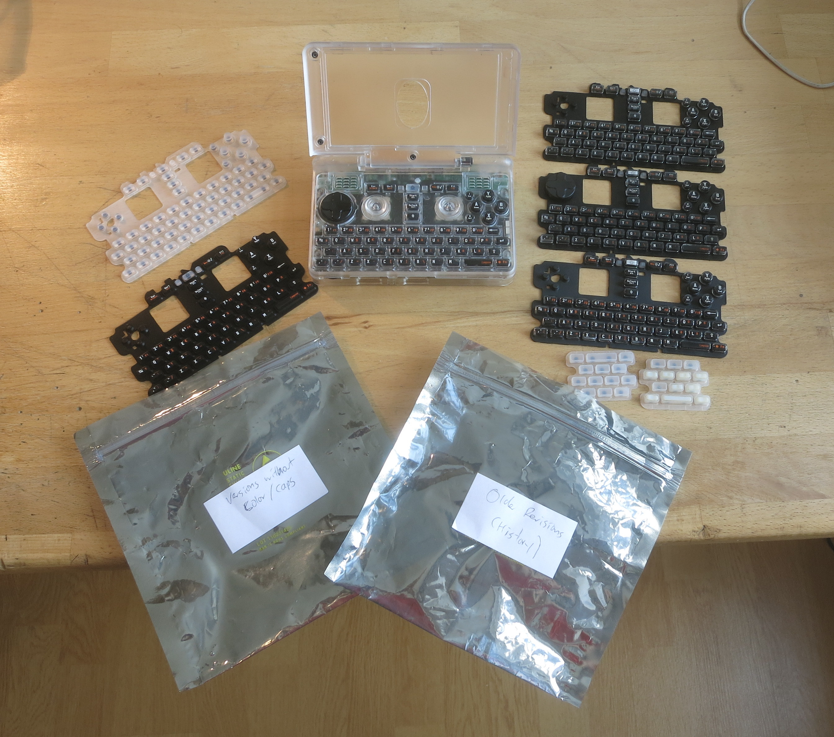

What's in the box?
Yes, that's my major complaint with the case.
Even with the Pyra battery, there's a bit more than 1mm space there that couldn't be fixed in the molds anymore, sadly.
So it can be made at least 1mm thinner by simply changing the shoulder buttons and the lower backside.
That's one of the first things I want to do once I got the funds for that. And it's really one of the easiest parts to change. Just unscrew the backside and replace it with the new one.
You don't even need to touch the PCB for that.
So I'll probably sell them later for 3 - 6 EUR, so anyone can upgrade :)
Ah man, it is only on the first person, I like how ED included the evolution of the keyboards though. Can't wait till I get them!

I noticed that it arrived with multiple keymats. Did you have a chance to do a comparison of the other versions? It shouldn't be necessary to mount them in the Pyra, just grab a hard cover book to set one on and see if you can tell differences between them.
I suspect that several of the alternate keymats won't actually fit properly in the Pyra case - I recall that there was a discrepancy between the keymat and the case dimensions.
@EvilDragon If the keymats manage to get scrambled along the way - is there a marking on the keymats to reveal which version they are? I.e. if someone does get creative with a screwdriver and install one of the alternates in the test case, how do we know which one is the right one to test on?

Also something I'm a bit confused whit the smiler caseupdate: in the Lowerpart of the case from the Pandora, in the Batterie Compartment, there is the Sticker whit the Serial Number,
And if you change this Part, than will the Sticker also stay on the thicker Part, unless you put it carefully on the new part..
