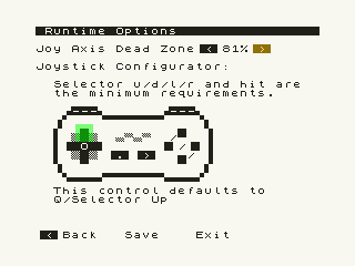

* Added a joystick configurator

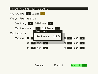

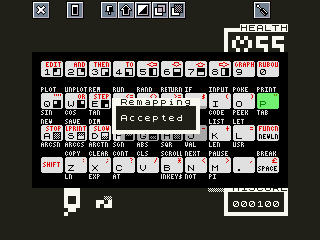

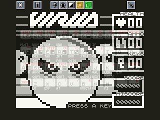

* Added fg/bg colour adjustment
* Added joystick dead zone adjustment
* Added volume control adjustment
* Added key repeat delay/interval adjustment
