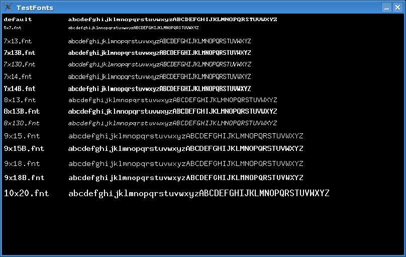

I'm working on an SDL game rendered to an 800x480 screen, so I'm assuming here I have direct control over the font size.. I should be more specific though.. I'm looking at characters 8 pixels in width.
I did two tests... a simulated text only screen (1234567890 repeated) and a screen shot of my game with ksnapshot, and printed at 220dpi and pretended I was holding a the paper as a pandora in my hands. It's readable at about 6 inches and tolerable at about 12, as long as the text is not too dense.
I think I may keep the 8 pixel font for secondary, non-critical text at the borders of my screen, but 8 pixels isn't enough for my main game text. And I'm starting to think of ways I can migrate away from small text and moving to larger icons where possible.
EDIT: For reference, here's a pic of the fonts that come with SDL_gfx, which should give a good sense of size. The 8x8 font I'd been working with was the default at the top. I know it's a big pic, but given the subject matter I hope you'll forgive me...

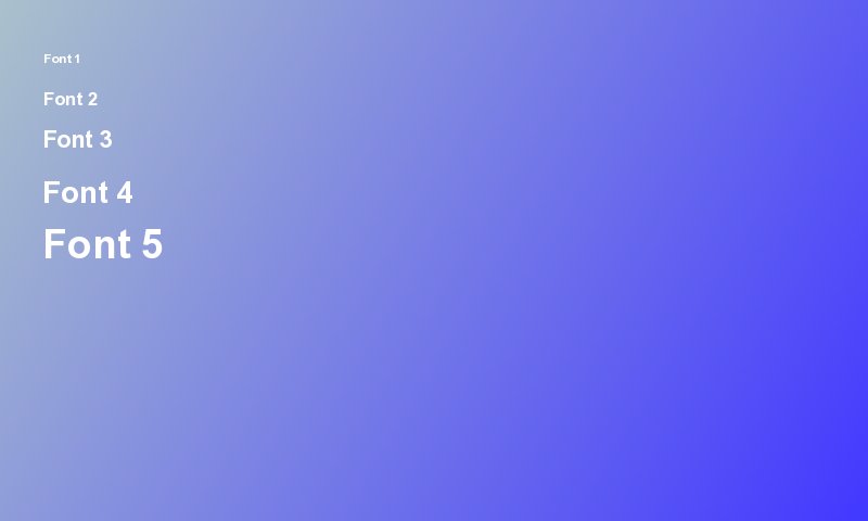

This is a message that EvilDragon sent to me, I hope he doesn't get angry.
EvilDragon said:
Font 2 is about the same size on the Pandora LCD as the normal gpmenu2x font has on the gp2x LCD.
Better use Font 3 on the big screen, looks a bit better.
Font 1 is very small but still readable.
EvilDragon said:
http://www.gp2x.de/panda/fonttest.jpg
*whips out photoshop*
the big F in font 1 is 7 pixels wide (including bluespace between characters)
the big F in font 2 is 10 pixels wide (including bluespace between characters)
the big F in font 3 is 12 pixels wide (including bluespace between characters)
Thanks, that's extremely helpful! I'll now be going with at least a 10px wide font if I can help it, but it's good to know my current 8x8 font is "very small but still readable"
