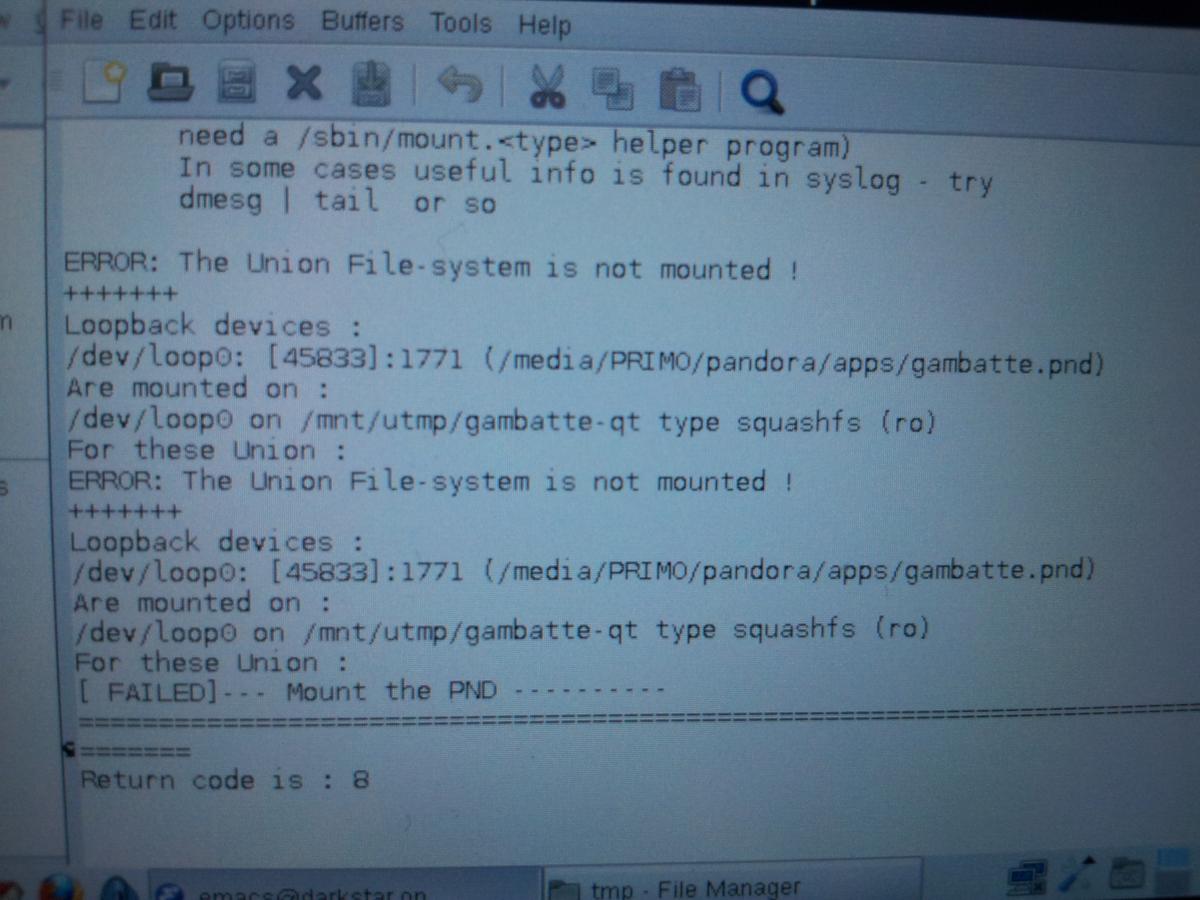

i posted here the out file for the gameboy emulator gambatte as an example,but any other emu i tried just give the same .out file

I'm afraid your SD card may not be Linux filesystem friendly.
What is the brand/model ?
About pnd, try to launch picodrive or pcsx rearmed. They work flawlessly.
yeah its one of the supported models.here's what i discovered:i have two sd.one of them has been dedicated only to slackware,the other has all the pandora stuff on it.but!the one sd i used for slackware,was previously used for pandora as well,so i brought all the apps and appdata to this sd to the second one.the second one had already 3 or 4 apps on it .now when i start slackware,i realized that teh apps i brought over from the old sd,doesn't work with the issues above.while the 3 or 4 apps i had in the second sd works fine under slackware.so i suppose its a matter of paths...its strange though as they ALL works ok in zaxxon
